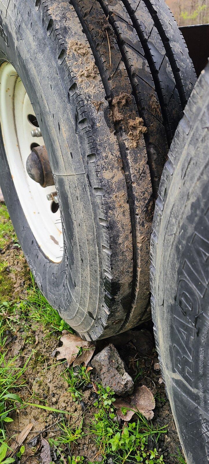

JR, I have long believed the AS tread style on cheap ST tires is the root cause of the caps getting ripped off in tight turns. In 2005 we installed Michelin XPS Rips on our 29' 12.4K 5th and ran them for 6.5 years, removed them and sold them to 200 bucks on CL with 60% tread left and around 40K miles and installed Bridgestone Duravis R250's and ran those for 4 year until the trailer was sold. The R250 is gone, however they have the R238. The XPS Rib, R250 and R238 are all steel ply tires. The closed Rib design on the outer rib makes for a great trailer tire. B/S Duravis R238

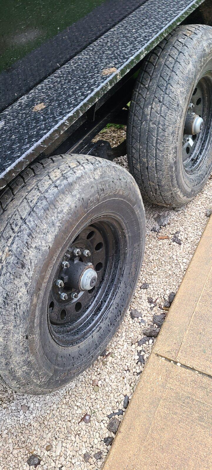

I was thinking about this thread as I was stuck at a RR crossing with my new dump trailer. After sitting there for about 30 minutes enough traffic behind me had cleared to where I could back up a few hundred yards to an access road off of a field. Backing into the drive across the opposite lane of traffic I got a good look at how much the new China Com tires were flexing. I was a bit put off to say the least. Tires were filled to 80 psi and trailer was loaded to max GVW. My tilt deck is the same GVW and I have done similar maneuvers countless times, even overloaded to boot. My Sailun S637's never flexed anywhere near so much.
Probably just as much to do with quality of tire as anything but these Ranier ST did not like a 90° turn loaded...seemed soft. I'll run the China bombs a yr or two if they hold up but then it's back to Sailun for me.
