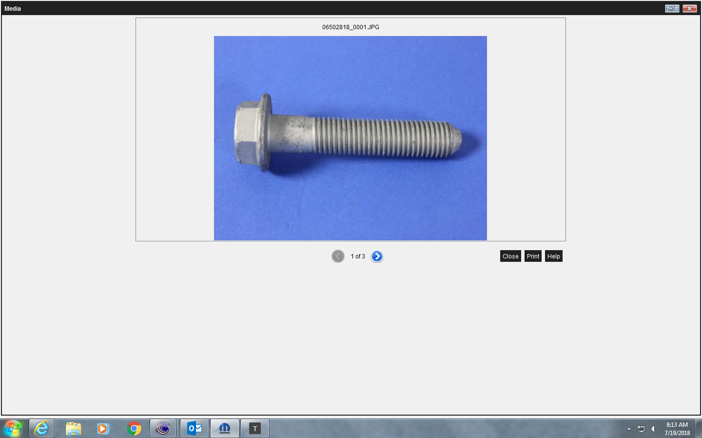

The first side took a bit of time as I was getting all the tools together. Hardest part was finding the right wrench or socket to take the top nut loose. 17mm - too small. 19mm - too big. 11/16" - too small. 3/4" - too big. I ended up using a 3/4" wrench and going thru the wheel well. Also needed my large Channelocks to hold the upper shock while breaking the nut loose. It took a 22mm and my impact driver on the lower mounting bolt.
