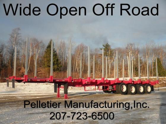

Those are 11R24. 5 tires on that Pelletier Mfg. trailer but they are Dayton for sure. Some of that stuff up there has 24" rubber which is larger than the 24. 5 versions.
20" tube tire = 22. 5" tubeless
22" tube tire = 24. 5" tubeless
24" is just plain big... ... ..... :D
Mike.
Also will stand more weight and abuse than a Budd or Unimount wheel. Plus brakes cool better, more airflow through the open rim.
Also that 4th trailer axle (Lifted in photo) can not be run touching the pavement on public roads in Maine. Only off road or in Canada (New Brunswick and Quebec).
Mike. :)

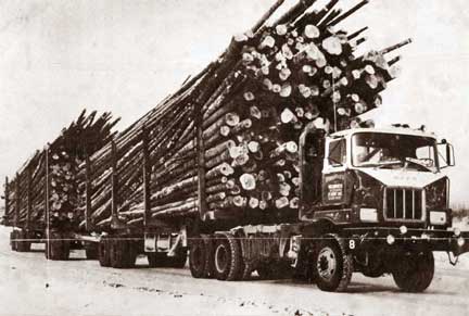

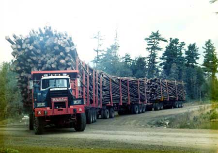

How come you didn't use this picture???
This is a 14' wide off road "Golden Road" special. :eek:
By the way, if you meet one of these loaded or empty THEY DO NOT MOVE OVER. Many an out-a-state-a has learned this the hard way... ... :-laf
Mike. :)
Dang! Thats a crazy huge load. It is cool how they loaded the long logs butt forward and the short logs butt back, they fit good. I would not want the job loading those little suckers. Is that a Mack or a Brockway?
Nick
Nick
Mack DM800 6X6 as I recall. Those pictures are older, from when Gerald himself was still with us. He was a hard working and well respected man.

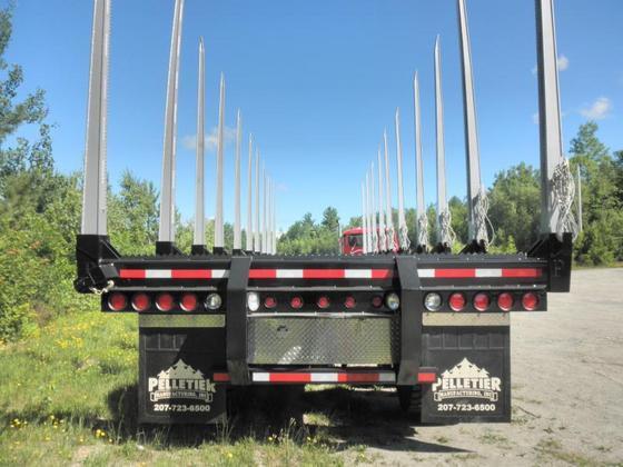

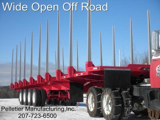

Another shot of the wide off road trailers, this gives a little better perspective as to how wide 14' really is on 102" axles...

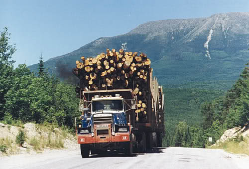

A little trivia nugget, then I gotta' go back to work...
I remember this truck when it was brand new, it was brought to Bangor to be shown to St. Regis Paper Company who was running off road equipment on what is called the "Stud Mill Road". That runs from Costigan (just north of Bangor) cross country to the Calais area.
They tried it out, I remember it coming into the Costigan mill to be unloaded. St. Regis did not buy it, then was sent up to Gerald to try out.
He bought it but did not like the "F" cab that was on it. He ordered a complete DM cab and fenders, etc. and proceeded to change it to a DM. That may be the truck with the triple trailers above, but can't remember 100%. If not, it looked just like that one when they got it changed over.
I don't think that there are many people that remember that nowadays. Makes me feel old:{... ... This would have been in the late '70s.
