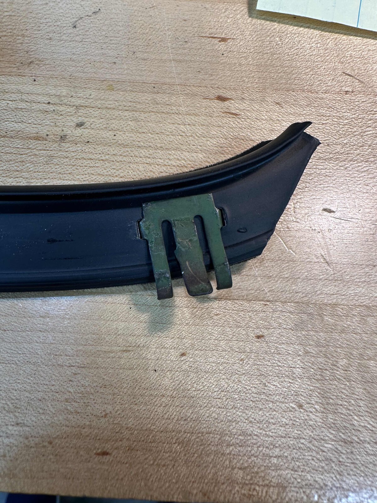

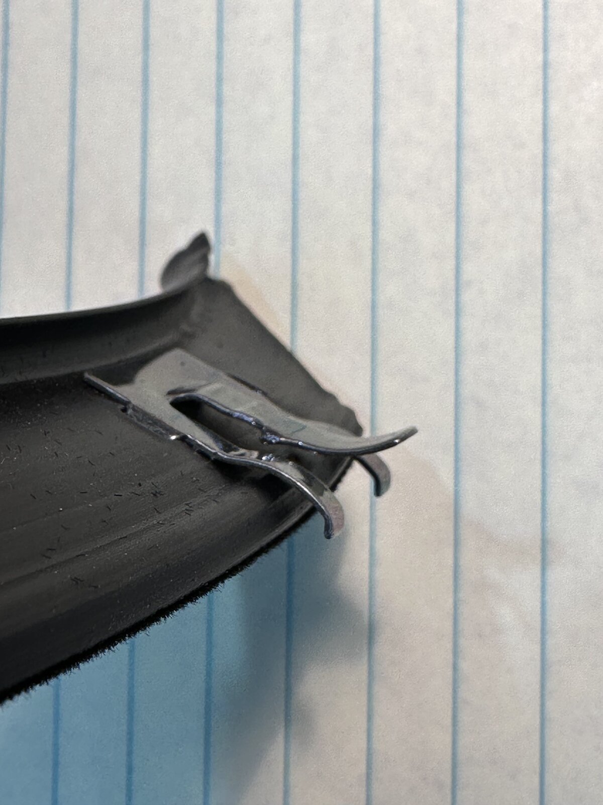

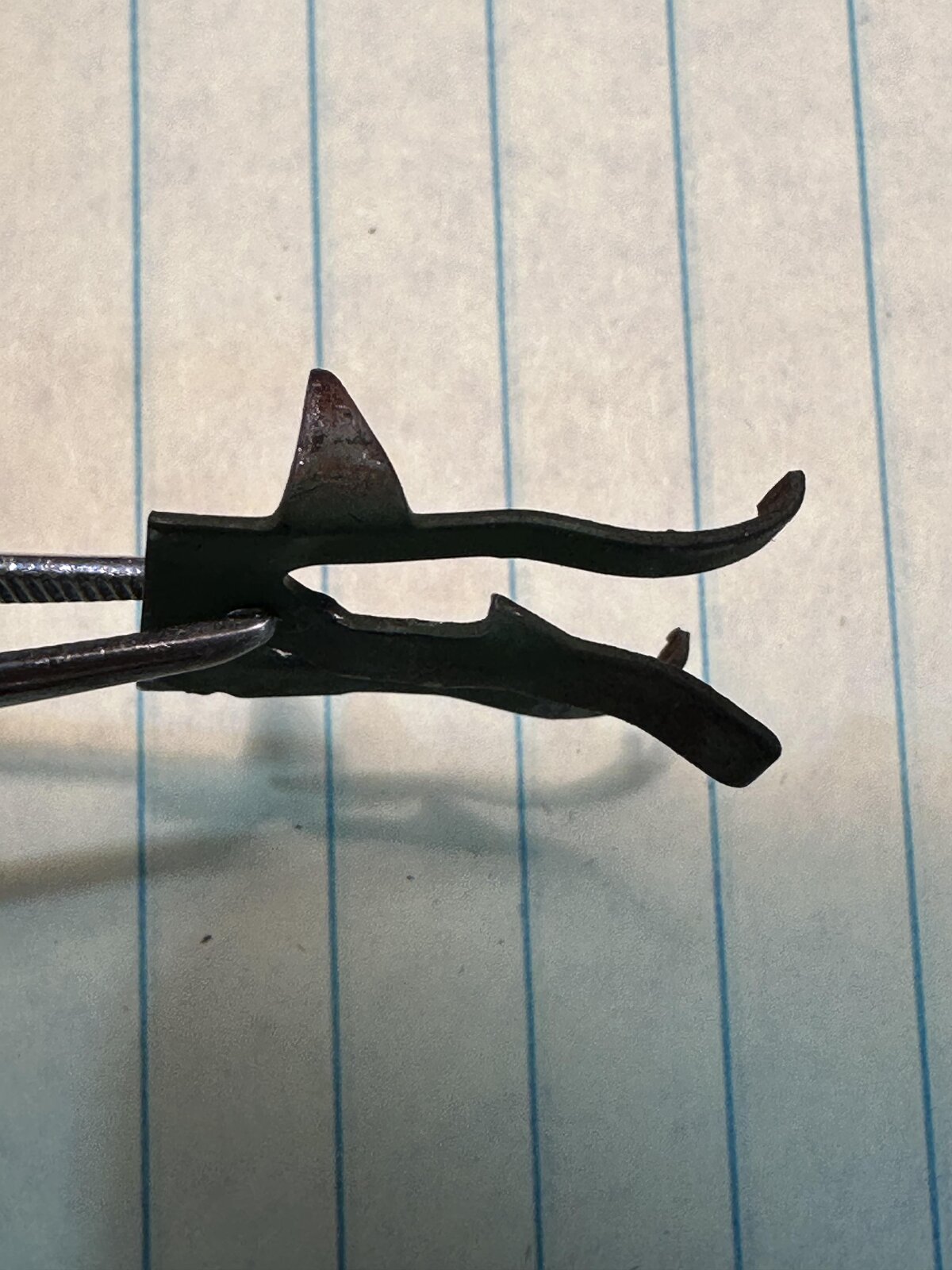

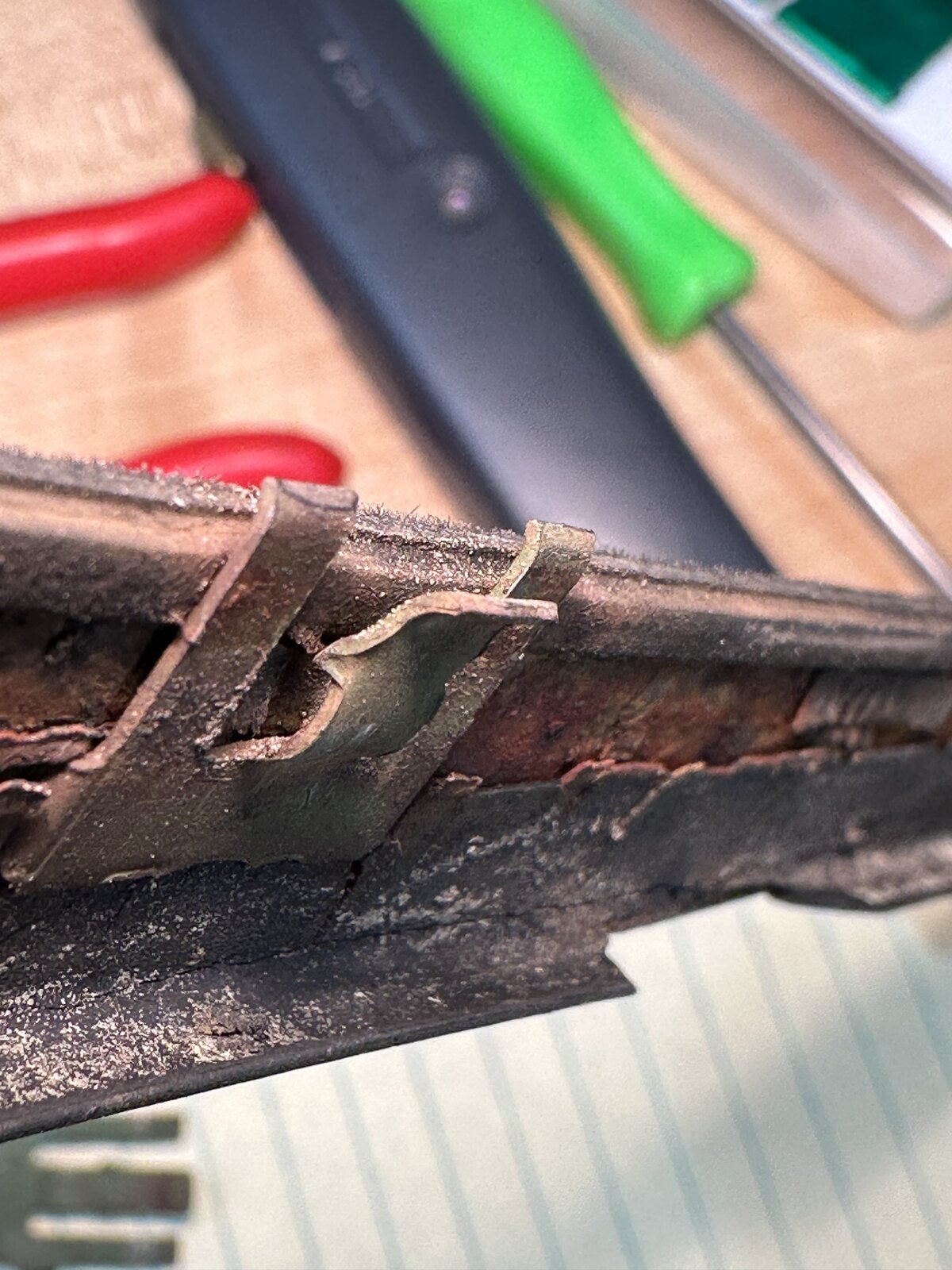

Oven's Garage mentioned this in his video of window sweep replacement. Apparently there is only one supplier for everyone and what they are using for attachments are inferior. I kept my old ones and pirated the clips from them which requires some care as they will break at the attachment legs. After swapping out the big ones on the ends I'm in pretty good shape but the manufacturer who claims to not have any complaints needs to up their game. I'm really happy that so much is available but I'm not going to cheer on a badly executed product.
