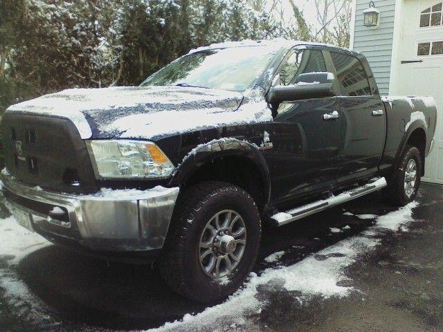

I found a set of Big Horn wheels on CL for a great price but tires are about gone.
I would like to go with the new Nitto Ridge Grappler 295/70/18 for a little more width and 4080 lb load rating.
They are 34.29” tall and 11.77” wide which is a little over 1” taller and less than 1” wider than the stock Firestone Transforce 275/70/18 at 33.19” tall and 10.98” wide.
My buddy put the 33/12.5/18 on his LB and they like look great but only have 3300 lb rating.
I don’t want to have to lift the truck or use a leveling kit.
Im thinking I should be ok and not have any rubbing or clearance issues.
Anyone running a similar size on a stock truck?
Also, the 275 or 285 / 70 has the lower load rating also unless I go with a 75 and that increases the height to 35”.
Thanks.
They will be close. I have the same size on my 2013 What I found was the tires rubbed on the controll arms at full hard over. You have the 3 link front end my 13 has the older 5 link system. I think you'll have more clearance than I had. What I did do to stop the rubbind was to drill and tap the steering stops on the knuckles for a 1/4-20 x 1/2" long bolt. the thickness of the head of the bolt was all that was needed to keep my tires from hitting the controll arms and I don't notice any loss of how tight I can turn. I do have a 2" leveling kit on my truck but these tires will clear the fenders with out it. On the stock wheels. Hope this helps.
On my 2008 truck I am using LT 285/70R 17 Nitto Dura Grappler tires on Mickey Thompson Side Bitter II rims. I have no rubbing issues at all, with no lift on the truck , but I did discuss with the tire supplier to pick the right size rims for my truck. I think they are Zero outset.
