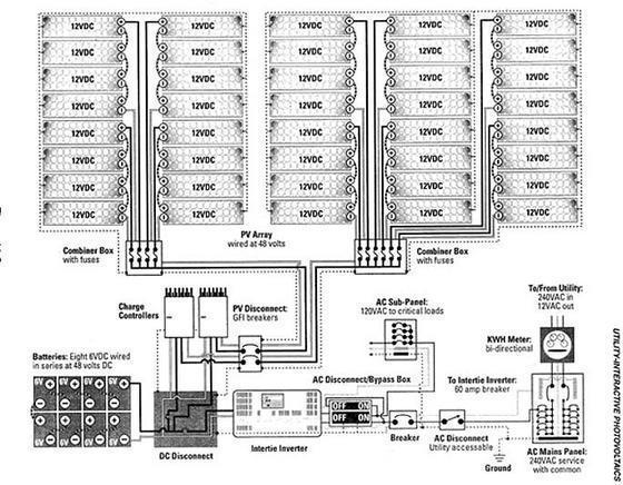

Would like to thank all that gave ideas on the tower that we put up for a wind generator for our Son's place. Its up and WE BE HAVING ELECTRICTY BEING MADE CAPTIAN!!!!!Its making 5kw wind gen alone!!! we made our own solar panels and are getting ready to install them for an additional 2400 watts charging 30 Trojan 125 6V batteries. His system is Grid Tied and when the batt's get fully charged it will automatically change over to running the local power company's meter BACKWARDS
Which means they are getting power from Son to the grid, kind of a odd set up grid tied usally has no batteries just put back to the grid but its SO UNRELIABLE up here, this way they will have power no matter what.
