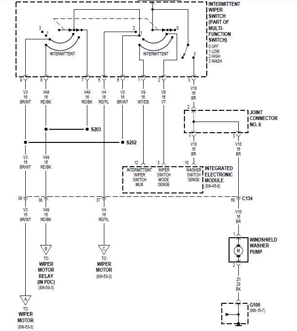

I have a 2001 Dodge Ram 2500 pickup Quad cab with issues to my windshield pump circuit. I've already confirmed that the pump is good as I took it out and connected it directly to the battery. Would you please advised me where to begin my troubleshooting exercise? I've already cut the connectors and determined that no DC volts is on the conductor (wire).

In looking at a wiring diagram for 99 which I would think yours is the same, it shows that the washer pump does not have a relay, just a switch which is part of the multifunction switch (turn signal etc) the wire shows to be a 16 ga brown wire. I have read on here of guys disassembling the switch and repairing but it looked pretty hairy to me. One wire to the pump shows to go to ground. It might be easier to install an auxilillary switch and abandon that circuit? bg.

One last question, which prong is the positive?
l or __
99 diagram

I just changed my multi-function switch. It was about 50.00 from advance auto. took about 30 min. to change. IMHO just change out the switch, easier then rewiring around.
