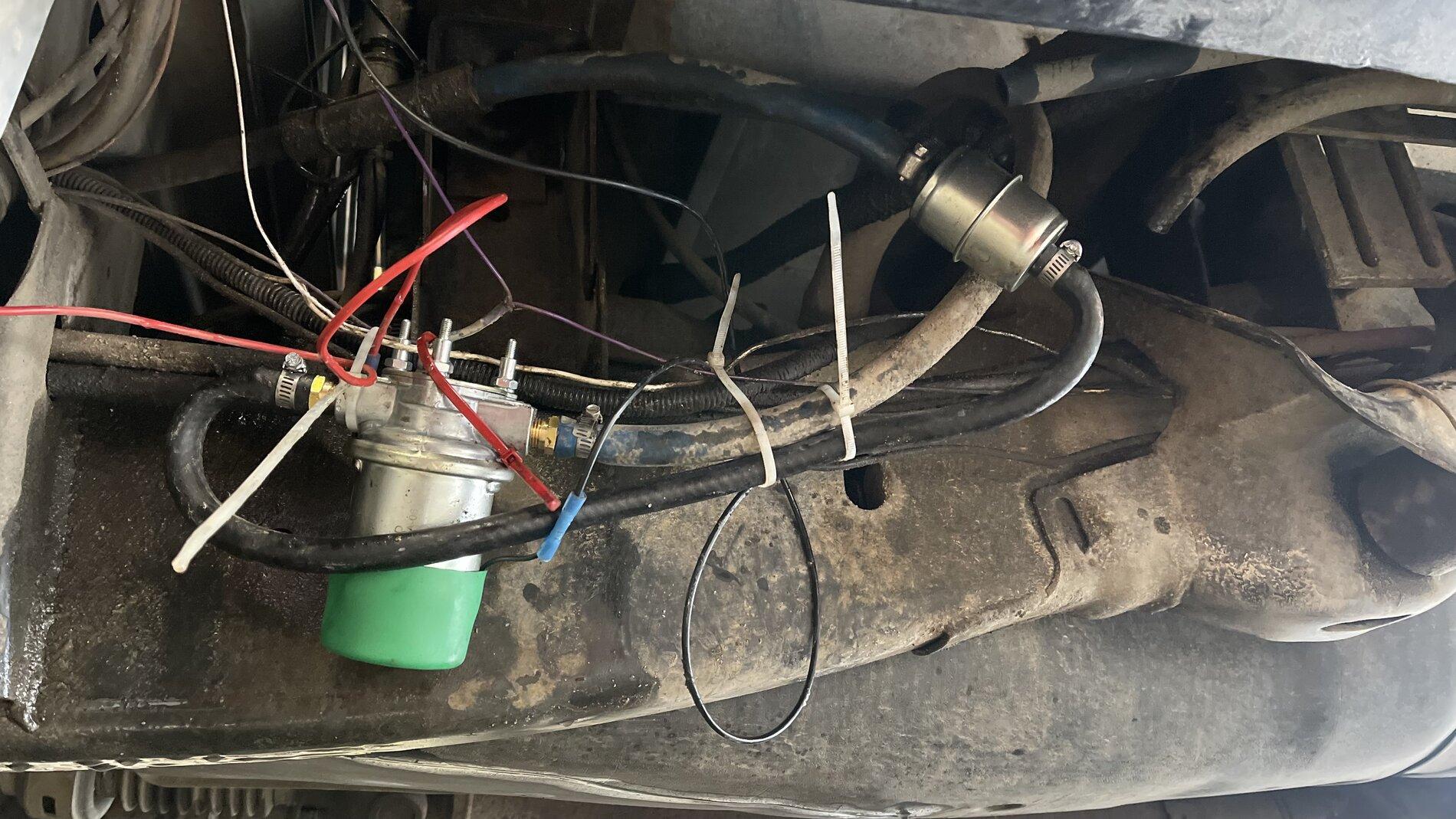

He's going to try plumbing it in behind the FASS system, but where should he open it up to prime it?
Before the CP3, I assume, then at the injector lines, once fuel shows up there?

Definitely before the CP3, that will tell you if the pump is pushing through the FASS or not. If you have fuel there just crank it. CR injectors will prime themselves unlike mechanical injectors.

So he’s got it running, but it wouldn’t push through the fass system, so this is the extent of present filtration?
should he drive it 8hrs on this?
There is no ill will when I say this but I would not send my son out on the road in sub zero weather with that set up. Zero water separation capability and next to zero filtration....A recipe to wreck a CR injector quickly.

Thanks. This one claims to be ten mikes, so hopefully it ls adequate.
Absolute or nominal? What’s the part number on that filter?
A screen door can be 10µ nominal, which is why nominal ratings are nearly useless.
