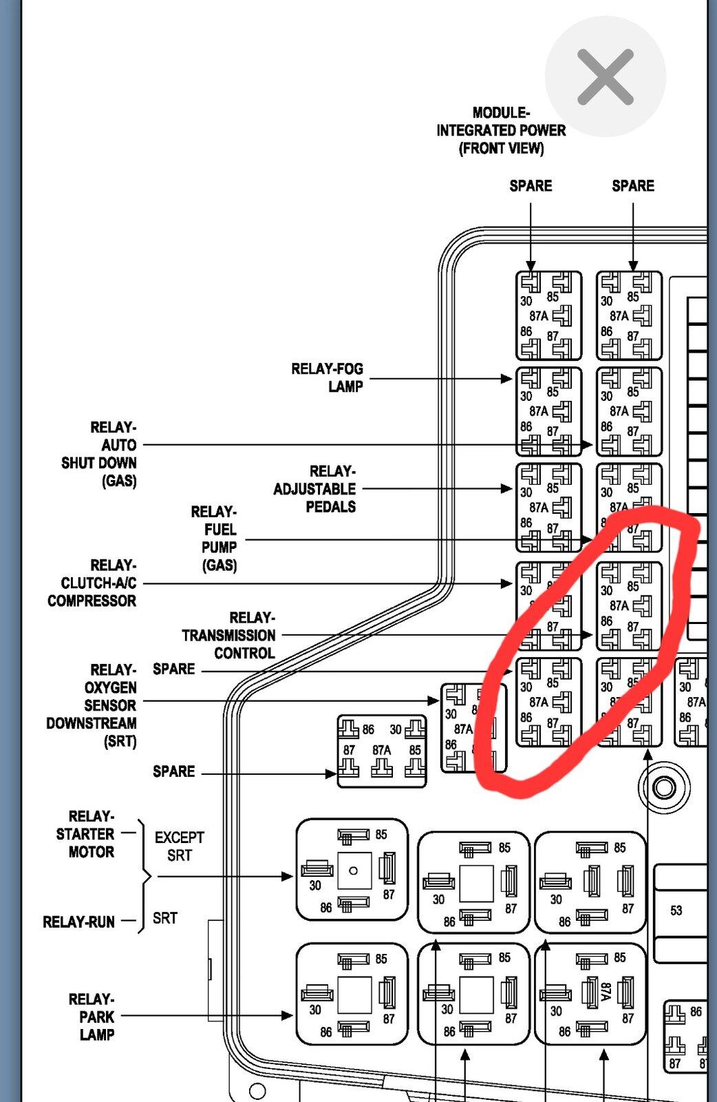

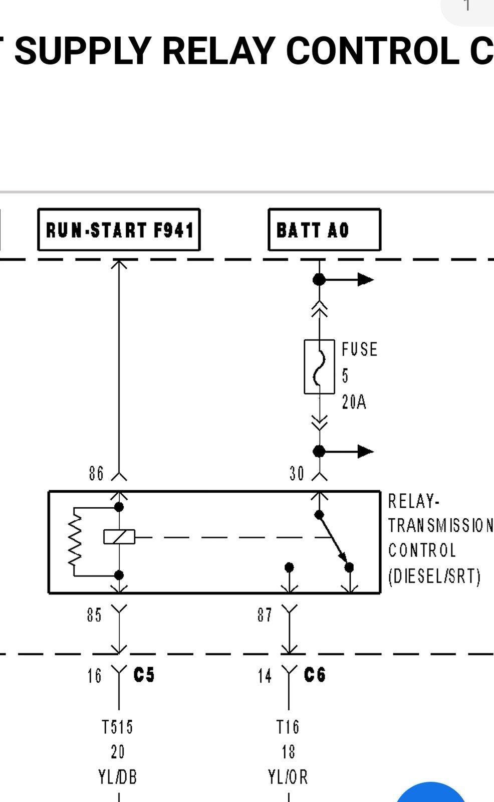

He can maybe swap the transmission relay and check that fuse 5 pretty easily as well.
And TDR for the win! Fingers crossed, but we have full functionality of fuel pump and transmission, with no codes and the overdrive function is back in the house.
Somehow fuse #5 was missing entirely. No idea for how long, or why. Maybe ATS removed it and it shouldn't actually be there, but it's been replaced and working, knock on wood.
