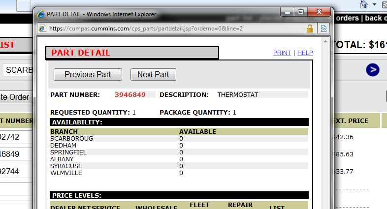

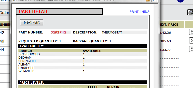

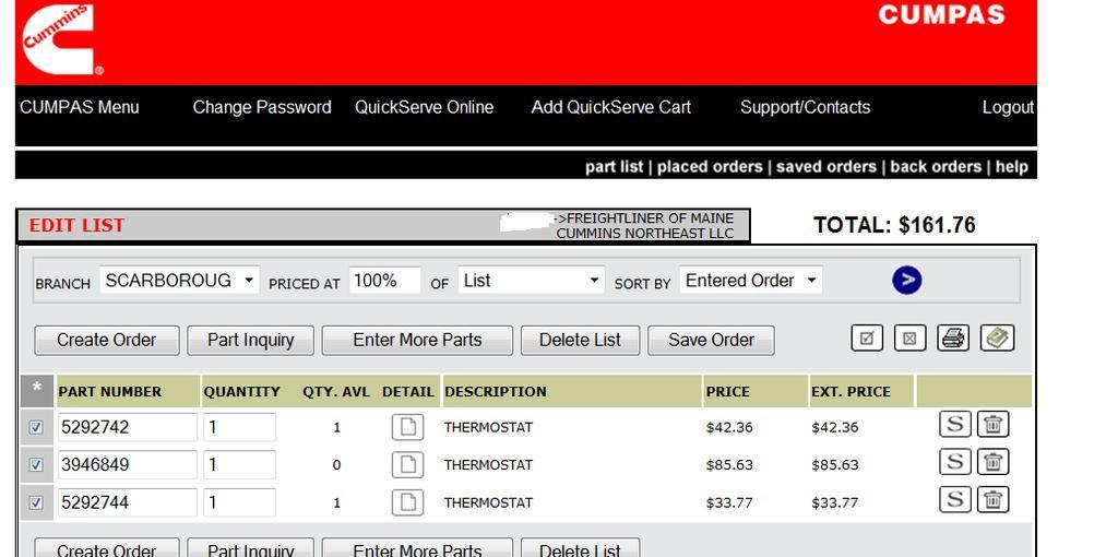

Cummins Northeast keeps a 180 (5292742) at every location. No 190's (3946849) at any location.

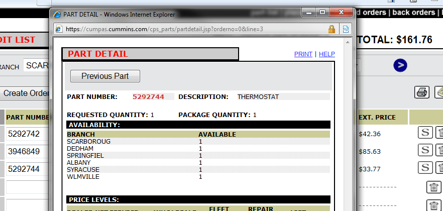

Just checked the 190 thermostat part number in my '06. That is a 5292744 and that sells for about $30.00. Cummins Northeast has those in every location as well.
That '01 thermostat is not common.
A little peek behind the curtain....
