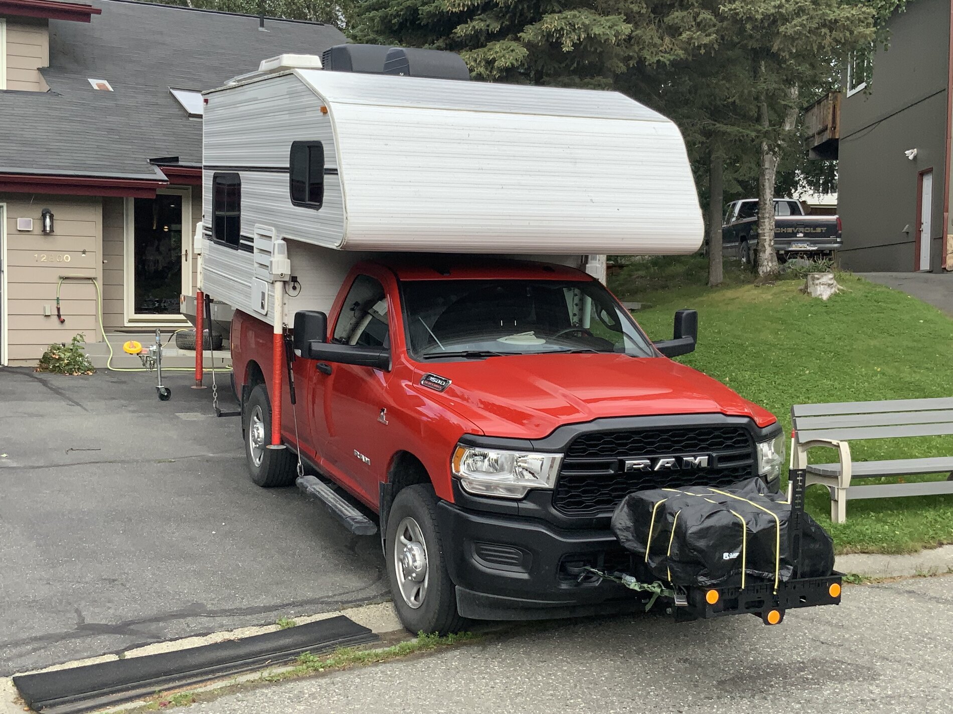

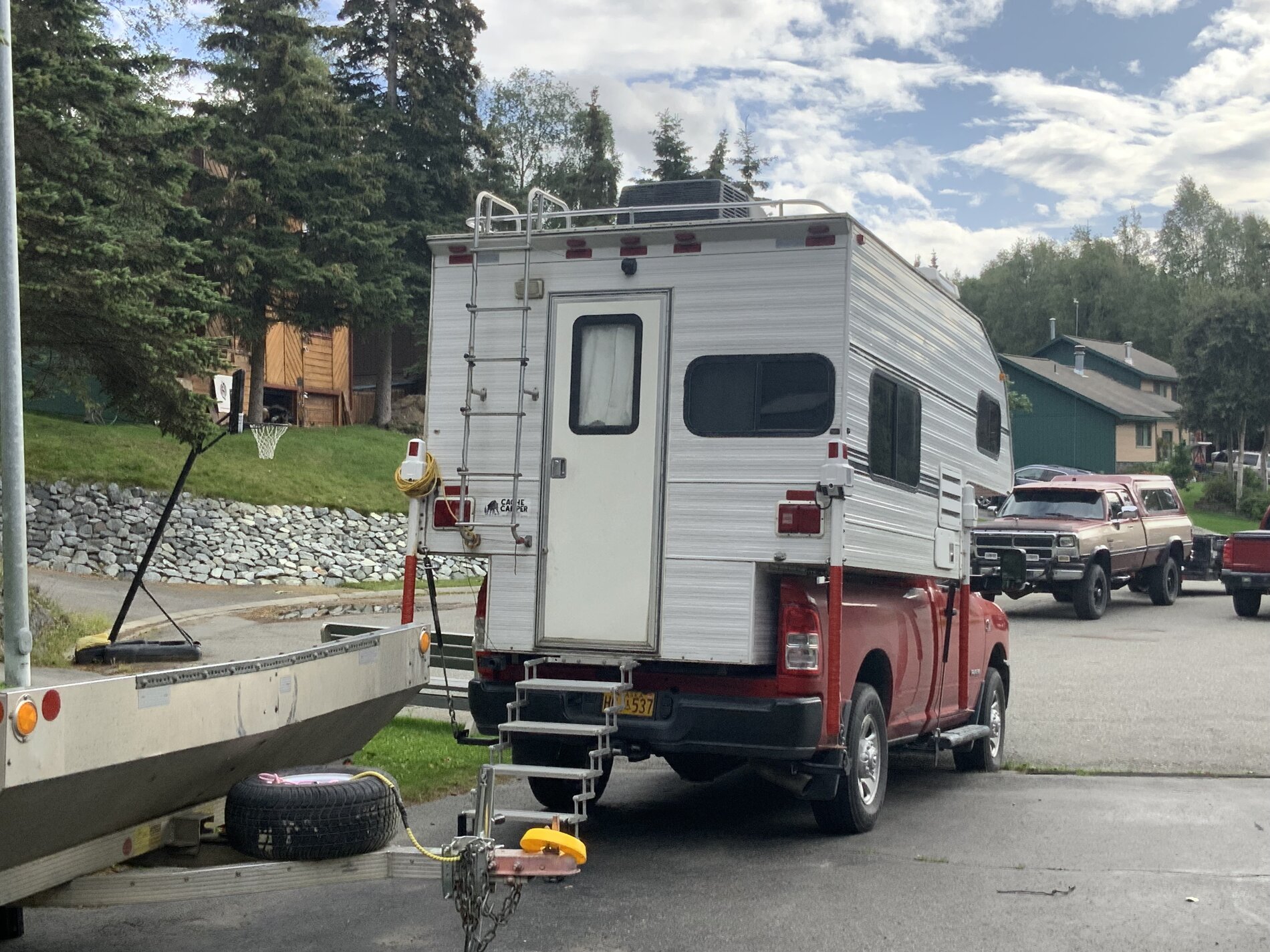

You got a beautiful truck and camper setup.
Well thank you. I’m enjoying it. It hauls the camper much better than my old 99 2500 5.9 Handles the weight better stops better steers better. Lots of power . I like the in dash tire gauge. I used to have to take a gauge and check them all every every couple day. The back up camera is really nice also . Only thing is being a regular cab it only has a 28 fuel tank and at 13.5-15 miles per gallon my range is not as good as the old truck which had a bit bigger tank and got maybe 19-20 mpg. Oh and I love how quiet it is

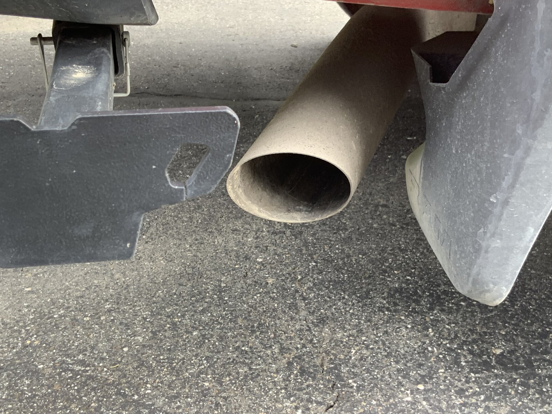

Compared to my old 99 with bigger injectors and edge box turned all the way up it’s pretty clean 19 k miles mostly hauling the 3000 lbs slide in truck camper. But certainly not snowy white
Your exhaust looks pretty clean from here.
If you go in say 6" is it clean?
I think your more then fine with that set up.
Get in a enjoy the ride.
