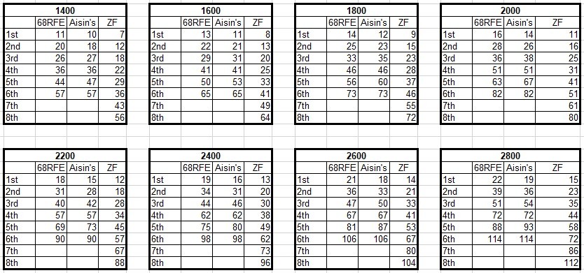

Just for fun here is a quick comparison of the 3 transmissions at fixed rpms. Speed is in MPH, tire size is 275/70R18, axle ratio is 3.73, and it's assuming a locked torque converter (even if they won't lock in 1st).
Interesting stuff but can’t you lock your transmission in 3rd on the steering wheel. Would that lock the torque converter and keep the transmission cool and still have enough power to go uo a pretty good grade. Plenty of torque in the engine
3rd gear won’t work that slow, too few of rpms. It’s too slow for 2nd to lock even.
You can use ERS to lock the trans into any of the 6 gears.
