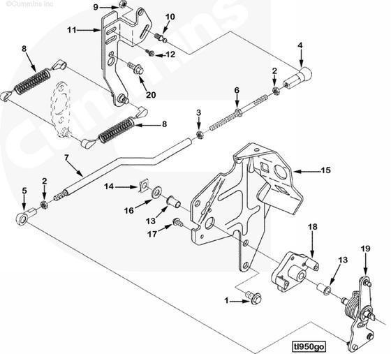

Go to a Cummins Dealer, your dealership didn't try very hard. I used the Engine Serial number from my '97 which is an automatic. I am pretty sure that a 5-speed truck will take the same springs.

Item # 8 on the illustration below.
Cummins Part Number 3931510
116 on hand at the Cummins Factory
Should cost $16. 00 to $18. 00 each.

I had the same problem pulling my 5th wheel at 7000#. Dodge did make a kit to repair that problem, but none were available when I had the problem. The kit did look like the major thing they did was install a heavier spring. I went to the hardware store and found a spring that I could mount on that linkage. I havn't had a problem since.
