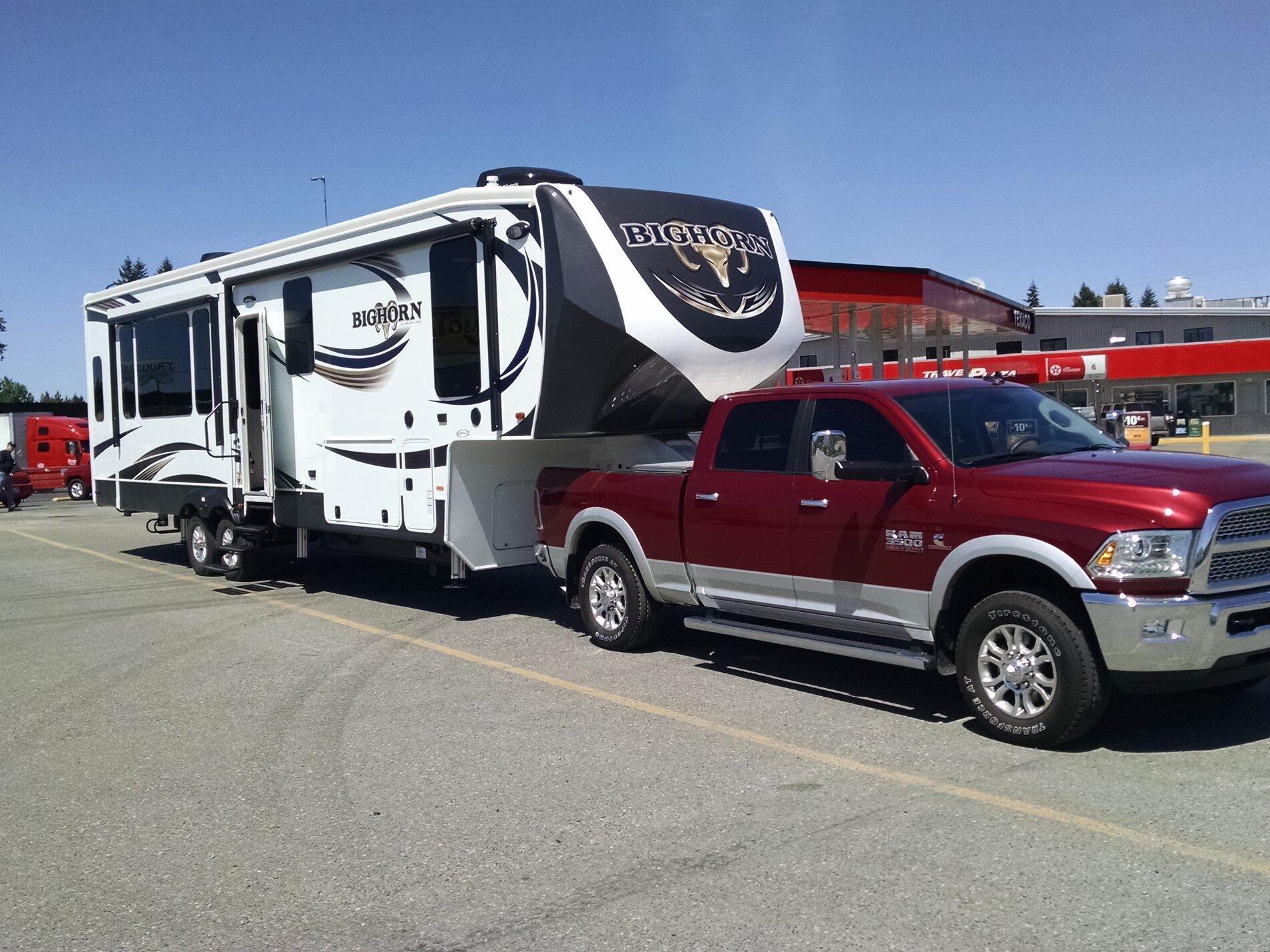

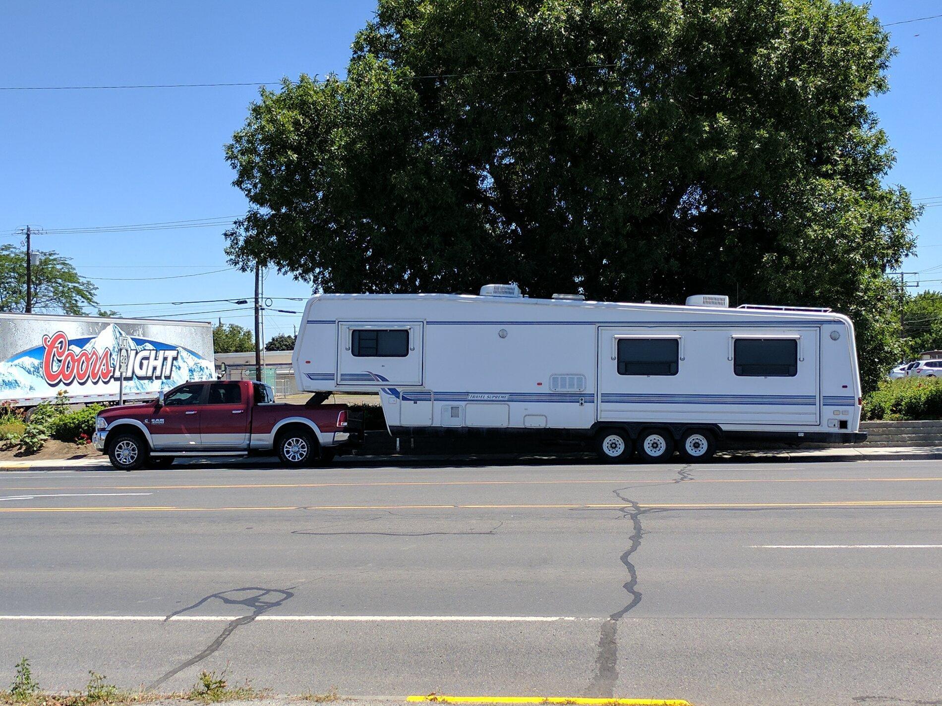

This thread is a case study of why anyone wanting to tow a 5th wheel of a mid to larger size should skip right over 250/2500's and start with at least a 350/3500 SRWs. We made two round trip to Arizona for the NW with the 16K Bighorn. The second picture is of son Travel Supreme that we moved in Eastern Washington.
