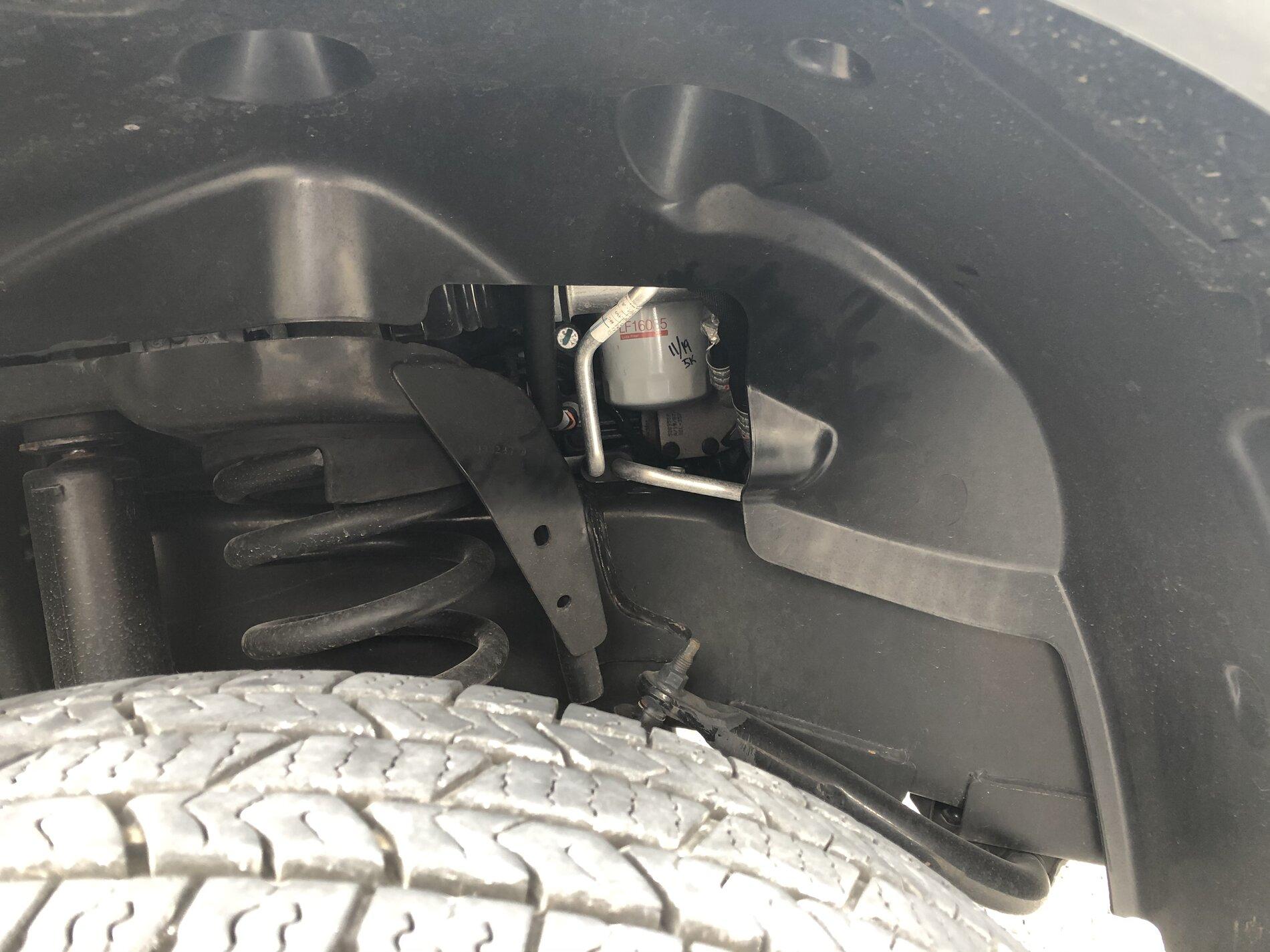

This truck is my 5th new truck with the Cummins in it, so I was expecting all of the filters to tight. I however wasn't expecting the oil filter to be so tight that I broke two wrenches trying to get it off. I have a set of filter pliers that I can usually break most filters loose with, I had never used it on one of my trucks as I usually take the air box of and remove from the top. I had bought one of the screw on lids for the oil filter from Geno's so you don't make a mess removing from the fender and thought this was the perfect time to try it. After trying the pliers and making no progress, I pulled out my fluted filter wrench I used to use on the 5.9s from the bottom. It really did fit good and flat so couldn't get much torque on it, so I decided to go from the top. I removed the air box and got out my new strap wrench as my old one had a little tear and I thought I should replace it last time I was at the parts house. I put the wrench on and preceded to dent the filter and nothing else. I then go my little 8 inch cheater added a little more torque and the strap broke. Feeling pretty frustrated at this point I got the fluted wrench back out and put it on tight with out the ratchet attached and then got the ratchet on it. I could budge it so I got a two foot cheater and it broke loose some what I turned it about 1/16th of a turn before the welds on the fluted wrench broke. I am running out options at this time but I had a cheap metal band wrench that fit so I tried it thinking its moved it should be easier. Wrong I couldn't move it at all. I then got my trusted old strap wrench put on from the top and still couldn't really move it. I then call wife for reinforcements I had her on the top with the strap wrench and I put the metal band wrench with a cheater on it and finally got it loose but it was tight for at least another half a turn. I say all of this to say I am ready to go on a gorilla safari hunt at the cummins plant.

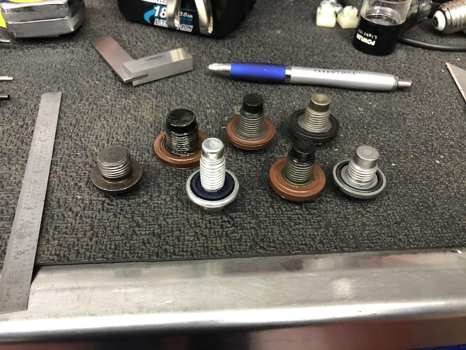

Getting the original filter loose was the big deal. That and dropping the drain plug and having a massive stream of hot oil splash out of the pan and into the driveway. Now it has a drain valve on it. Seems like I have a small collection of drain plugs now. LOL

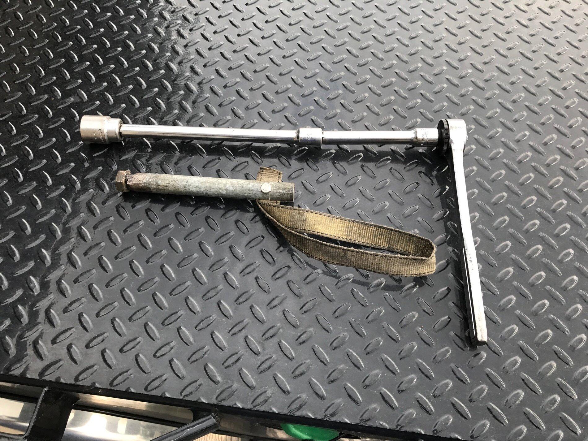

I have a strap filter wrench that has about a 1.25 fiber strap, I go from the top and get the strap right up to the top of the filter up against the flange. It takes a 1/2 socket extension and I use a 1/2 racket with slow pressure and it slowly turns. Yes the OEM was installed by the animal that sleeps in a cage in the corner of the factory. The instructions call for the ratchet handle to be across the top of the filter, and not sticking out from the side of the filter, which one might think gets the most force.
My BIL made me a nice strap wrench about 10 years ago, for a Christmas present, after I commented how well I liked his when I used it once at his garage.
It has never failed....and is verrrrrrry durable. It actually got partially retired for a bit when I bought my 2013 RAM 3500 and 2014 RAM 3500, but I use it every oil change and fuel filter (separator) change on my current 2018 RAM 4500.
It has a 15/16” nut and I use my 1/2” drive ratchet and extensions on it.
Looks like my Craftsman ratchet!
I've changed the oil twice on my 18 2500 2wd, accessing the filter from the fender after removing the wheel.
Used Geno's cap and pre-filled the filter without issues and not a drop spilled.
The original filter was tight but my old KD strap wrench worked fine.

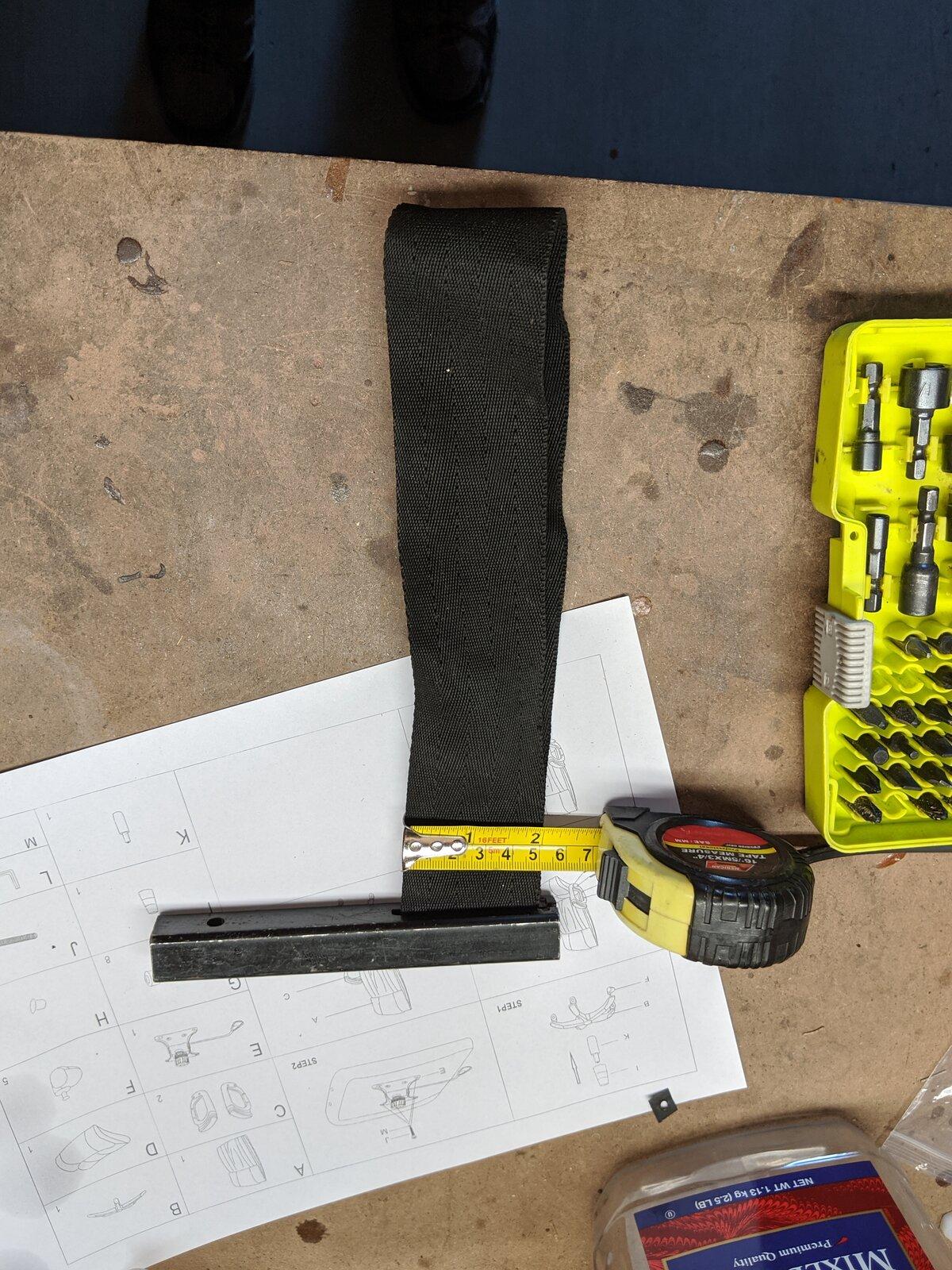

Here is a picture of my strap wrench. Web is actually 2" wide. No way a filter is going to win over it. SnoKing

SnoKing I have a very similar strap wrench i have used for years. My strap is not quite as wide but I always use it at the fill end of the filter where it's strongest.
