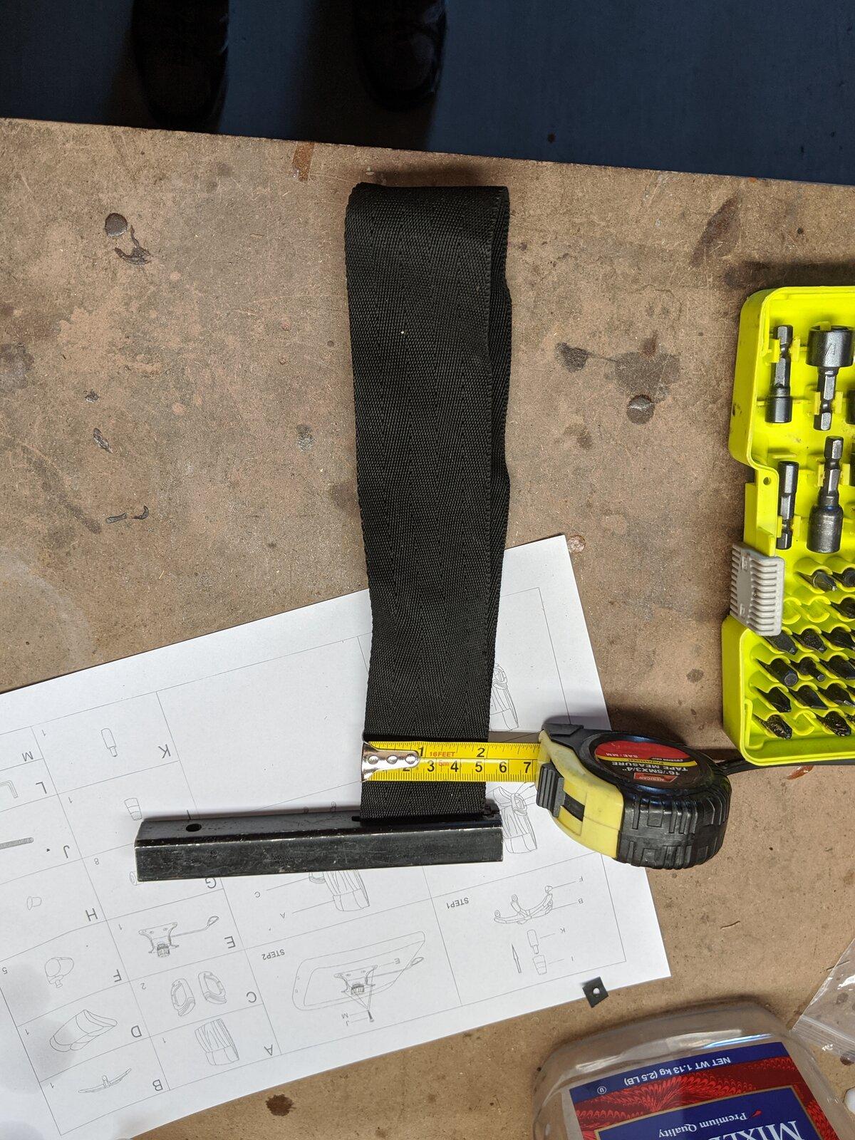

Here is a picture of my strap wrench. Web is actually 2" wide. No way a filter is going to win over it. SnoKingView attachment 117739
I had the same identical strap wrench. Thinking of useing some old 2 inch webbing from some old ratchet straps that I use for hauling hay that have worn spots in them to replace my strap on my wrench.

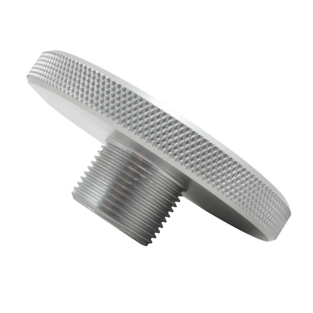

Since we're on the subject of changing oil and different methods, I wanted to point out that Lisle makes an oil filter cap to thread on - it's like 10 bucks. While I'm a supporter of Geno's, not everyone wants to spend 30 bucks on the fancy aluminium cap.
I used the Lisle cap and didn't spill a drop removing the filter. I also found that I was able to lower the filter down onto the frame and let it sit there while I threaded on the cap...no trouble. Maybe I got lucky, but I didn't see a need to cut a rectangle piece of plywood to drop down there like others have mentioned.
Anyway, just wanted to point out that Lisle cap is available and cheap and it works.
this is the one I got, I think from ebay for $10
I have tool envy! No screw on filter cap, no 3/8" drive filter removal cup and no special pc of plywood. :cool:
Think of the extra tools you could have if you'd just change the oil filter through the wheel well. Everything we do is just an excuse to buy another tool and justify the purchase with "look how much I saved doing it on my own!" :D
