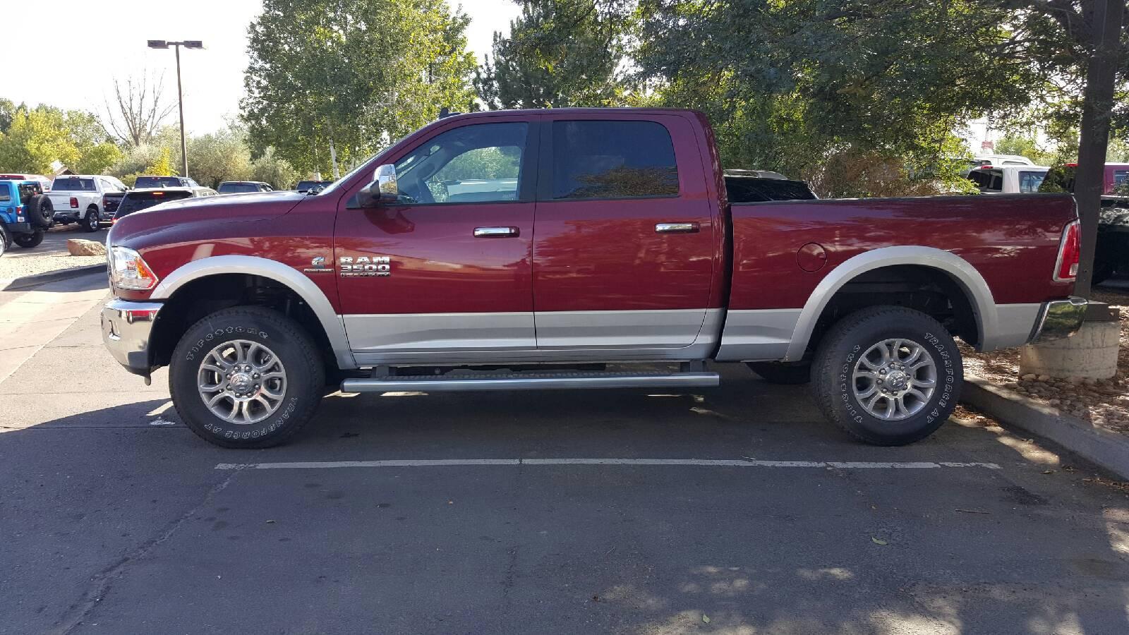

I'm looking into buying 18" Rims, would love OEM Rims.
Question, I've the Freespin Hubs on my Truck, which rims will fit my Truck?
Also, do all that rims have the same bolt circle? Ar they all hub centric or bolt centric?
Do all rims have the same load capacity from factory?
Offset 43mm vs 57mm a problem?
Any traps that I have to avoid?
Reason for this - I desperately need more LI to my tires and found that 295/70-18 is way better then my todays 315/70-17.
Any help is greatly appreciated.
Ozy
They are lug centric(and should be balanced on a machine with lug adapers) and the Laramie ones are the best looking in my opinion. Someone will have to tell you about the offset issue and if the lug nuts are the same thread sized etc.
I know the suspension change (2013?) caused the backspace change. How they will act, look and fit on a 3 gen, I am not sure. The Laramie wheels have a smaller and closed center. This poses a problem for the free spin hub. I always thought these (and all Mopar vehicles) were hub centric.

Well, will there be someone out there that is willing to put the alloy wheel/rim on a lathe and turn out the center section to accommodate for the FS Hub?
Otherwise I'm bound to the steel/chrome clad rim.

I agree that the Laramie wheels are the best looking of the bunch. I looked into them for my 05 before going 19.5’s. My plan was to have 2 machined out, and pay the dismount/mount fee every couple years. But I went 19.5’s, as I was often over 7K with the 05. Hoping I can squeeze by with the current setup and 18’s until I buy a 5th wheel.
I would be willing to machine all 4 rims to have the ability to rotate, pretty important to me.
