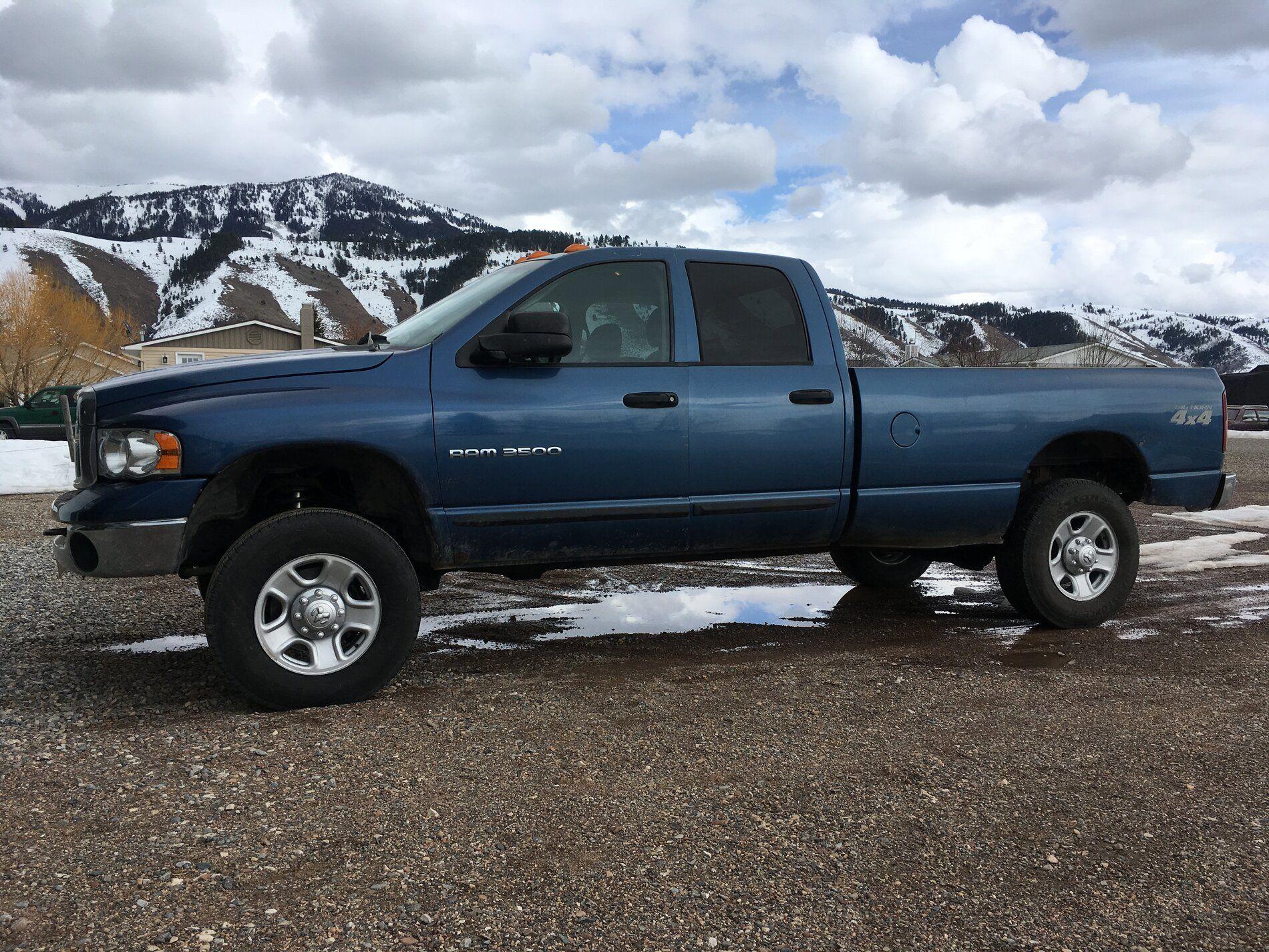

2018 18" steel wheels and hub caps on my 05

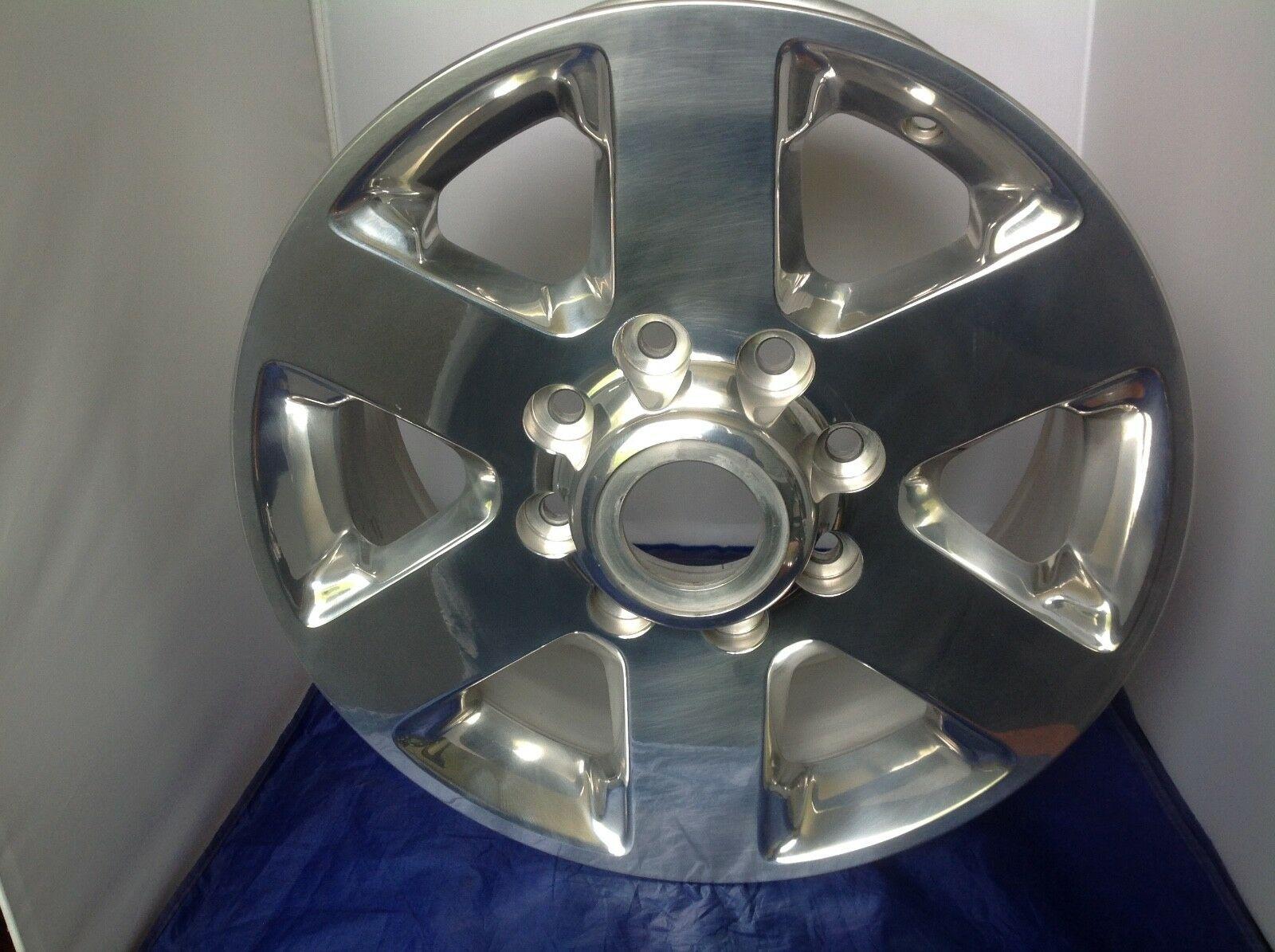

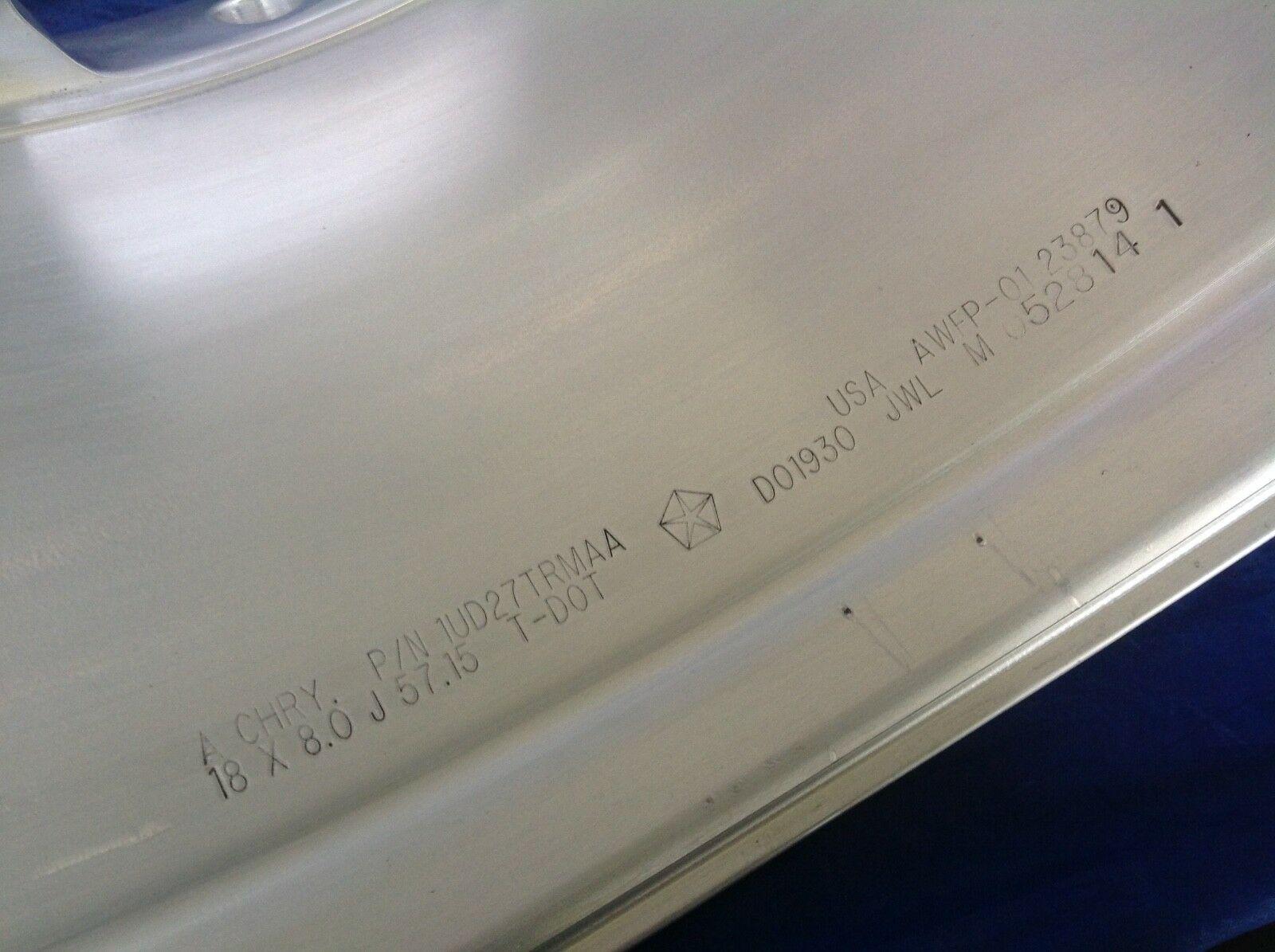

Looks like I'm going to be the Guinea Pig as I have a Dynatrac free spin kit! It's hard to ignore the ratings on the 18" tires! I'm currently lurking on Craigslist to find a set of the 6 spoke wheels depicted in the attached photos. I note that this is an Alcoa US manufactured wheel. I will have a local machine shop machine out the centers on one and once we have it nailed down do the others. I do not have nor care about hub caps as I want to rotate. I'm okay with the industrial look. :)

Flash forward I just scrapped my factory longhorn wheels that I had opened up the outside holes on. I could not get them to balance. 4 tire shops. Lug mount on two machines and every time I went out of state onto smooth roads the truck would shake your fillings out at speeds above 65. I went with a set of ProComp aftermarket wheels now it’s smooth right all the way to 90. My advise Don’t waste your time on re working the factory wheels to fit your free wheel hubs.
Thanks for the heads up. The idea of going with a machine shop is to see if they can do the cut out on a lathe to keep it round. This is where the project could end either because it cannot be done or it's too costly. If I get past this stage on one wheel then I will take it to Discount Tire to see if it will balance. If one balances then I will pull the trigger on the other wheels. I will have to get a good deal on the wheel purchase and since I run two spares I will likely have to purchase two sets. The alternative would be to purchase aftermarket wheels but I have always found that the offset to be too great on aftermarket wheels. I want to keep everything tucked into the wheel wells.
I hear ya . I spent quite a bit for it to not work out. I should have just gone aftermarket from day one. 18” wheels the choices are slim. My offset is a bit more than I like but.... the price was right for the procomp’s.
I had really good good luck with Vector wheels but I didn’t like the style available in the 18” size.
I was looking at the Method 701 HD - 18" x 9" - 8 x 6.5 18mm offset and 5.75" back spacing. The OEM 17" wheels are 44mm offset and the OEM 18" are 57mm. I don't know the backspacing for the OEM wheels. I spoke to Method and they state the 18mm offset put the tire right at the edge of the wheel well. That will work as I also have fender flares which give me a couple of more inches. I also note that the Methods have a 4500 lb load rating. Most of the 18" tires have a load rating between 3600 and 4000+ lbs. I don't know the load rating on either OEM wheel so I will have to research that issue. All good for the Methods but they are $362 each before tax and I need 6!!! :eek:
3rd gen factory back space is 6.25", 4th gen is 6.5". Factory rims are rated at 3500 lbs but that is not necessarily the manufacturer rating, it is what the Dodge decided to assign them for the axle weights.
