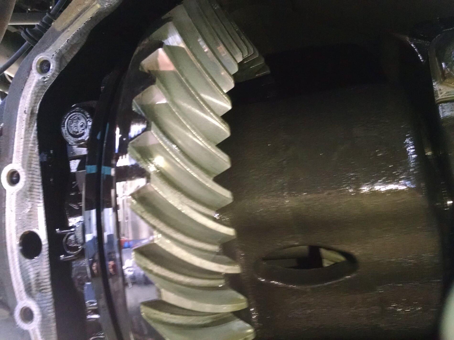

They don’t do a final polish job on the gears anymore. Truck and automotive rear end gears are finished, on a scale of 1to10 with 1 being poor and 10 being perfect, from the factory they are a 4-6. They are designed to be run in in use. The final polish is done while you drive. That is why that first gear oil change is important if you want really good service life out of your rear ends.

The break-in is for the gears, not the engine.
As others have said at 7200 miles you’re fine, hitch and go.
Change the factory fluid between 10-15K miles.

Gear mesh - yes, makes sense, even the aftermarket has this in the manual for new gears. Go light, go slow to allow for building a nice teeth surface.
As has been said, it's for the diff not the eng.
After 500 miles on the diff, you can do anything you want. So we simply took a long day trip around the state. End of day it was ready to pull.
factory gears may have a higher qaulity machining process or better heat treatment than after market but still your trying to work hardening the gear face without over heating it. thats why they dont recomend heavy loads or high speeds in first 500mi from new
