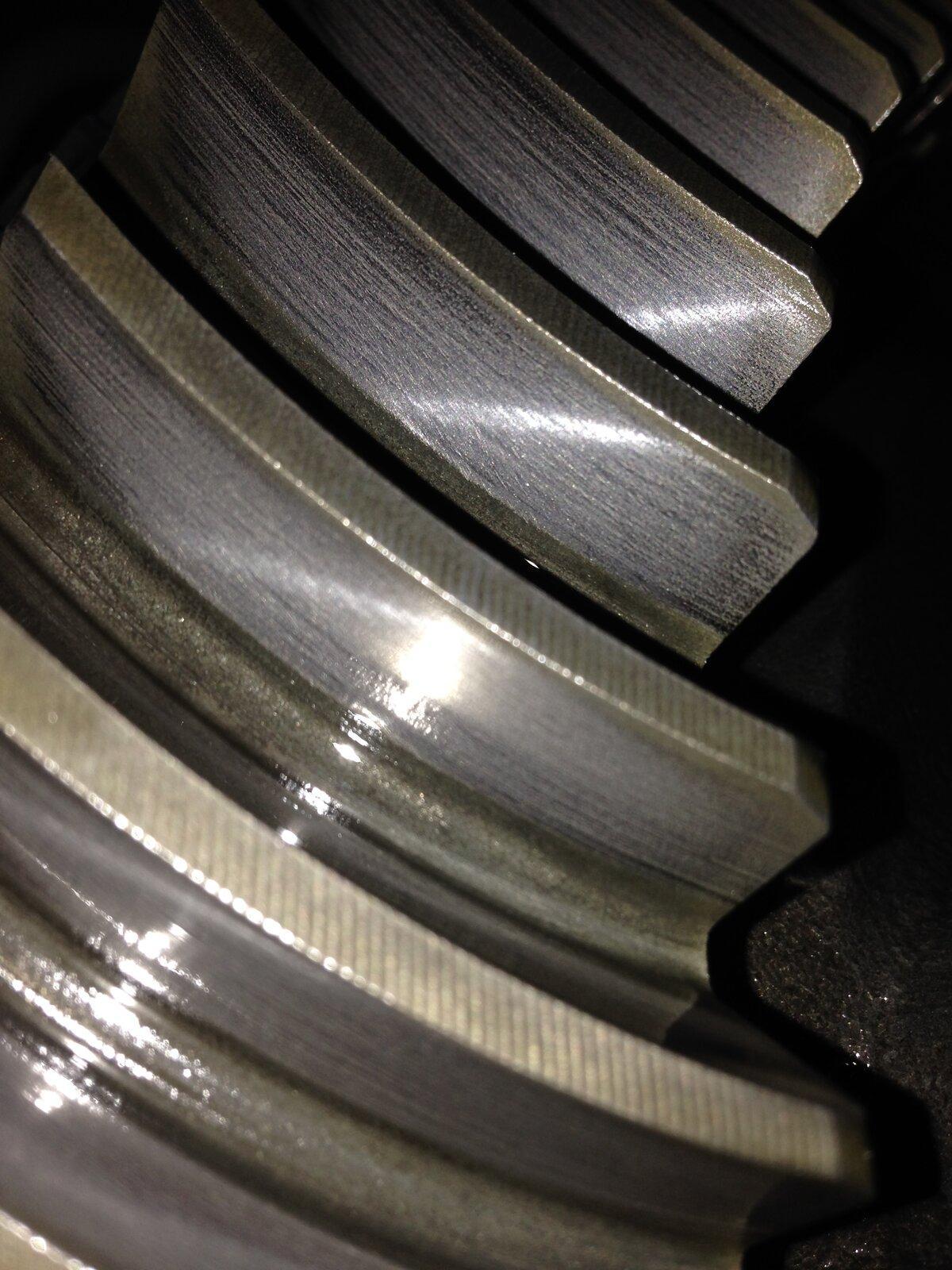

My 11 HO DRW bought at DaveSmith Idaho with 13 miles. I literally ran the hell out of it up to 90 n back to 60 wash rinse repeat all along I-90 to Seattle.
the gears looked like new at 65k.

This is the result of running the hell out of my 11 HO DRW as mentioned. I removed the MagHytec at 65k to trade in on current 15. There was around 55k on the AMZ/OIL SevereGear. I also towed about 1/2 of the miles at 28-29K combined.
