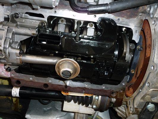

I did mean to post back and warn you, make sure the windage tray is in good shape and not broken. My friend took off down the toll road with his newly rebuilt TDI engine and about an hour later it started making a clicking which changed to a rattle. He had put in his tray, and it was cracked. The vibration broke it loose and it plugged the oil pickup and starved it. A crank, new piston, and all new bearings later he was good to go again. He wasn't very happy about it to say the least.
Windage Tray

I did have to R&R pan to reseal, my error. But the good news, its got a couple of hundred miles on the reseal and no leaking observed.
The pan needs more protection than the plastic one and the aluminum Panzer Plate seems like it should prevent common sources of pan damage. Any TDI owners, ounce of prevention on this one is a big plus.
My novice R&R comments, 16 of the bolts are a no brainer, 2 bolts are mildly nasty and the last 2 are down right what were they thinking. These go into the oil seal carrier brass inserts. I got a 10mm 1/4" drive swivel socket but it did not clear the solid flywheel rim. On OE DMF applications there are two recesses (quite accidental) that allow much better swivel socket access. I had to grind clearance onto the swivel base for initial loosening and then I used a 3/16" ball end allen to take them out. Yes, they are 5mm. The 3/16" does a nice job its a bit looser and doesn't force the bolt into places it doesn't need to be in. BE PATIENT!
