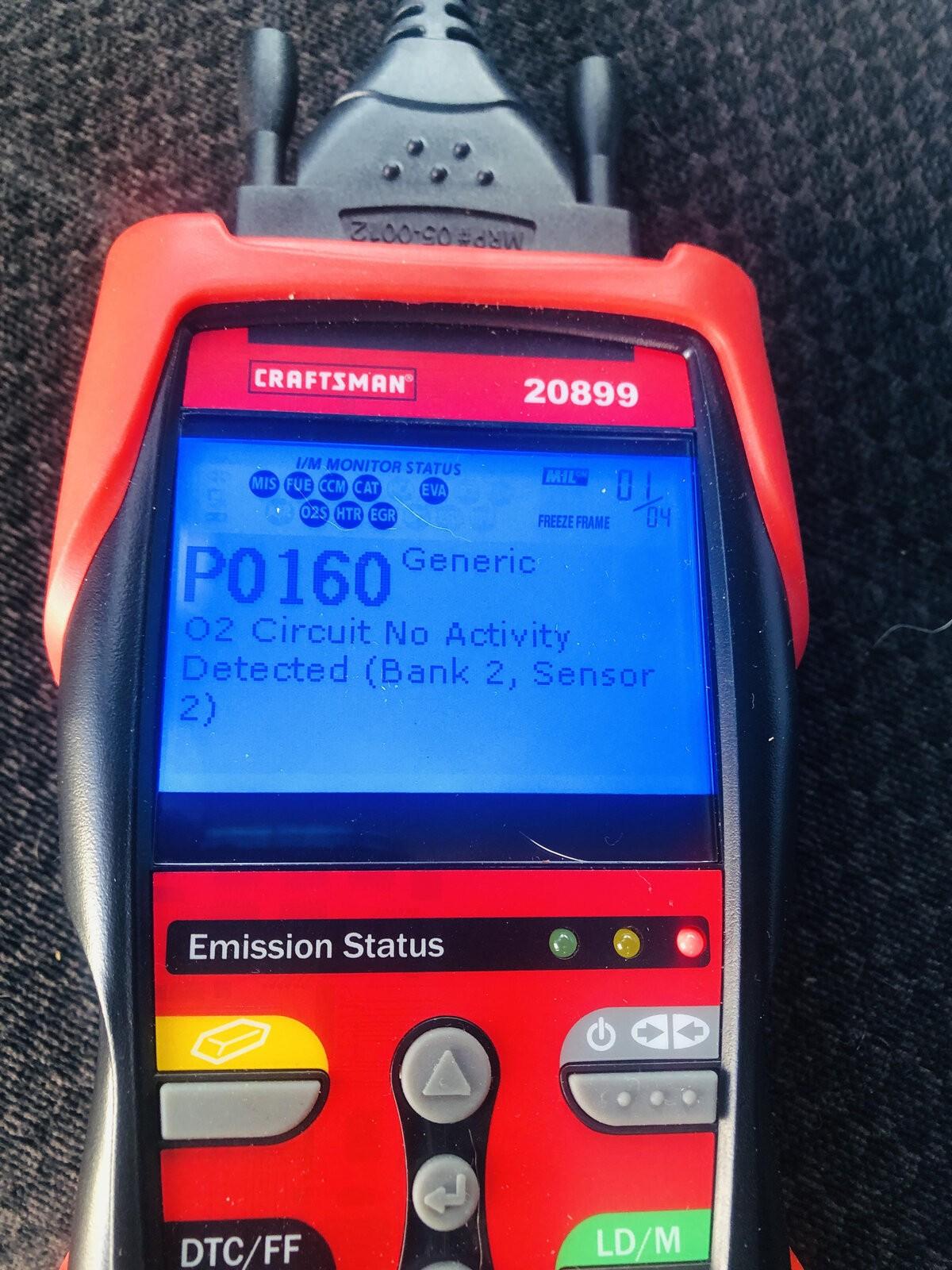

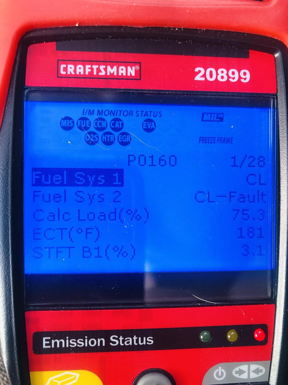

2/12/22 - Brought out OBD2 scan tool to read the codes. (trying to perform steps named above. Got my PIN from the dealer too). My code says P0160, Bank 2, Sensor 2). I guess one of my sensors went bad. I tried to just delete this code from the system, and it won't let me delete it.
Also the reader says 01/04, which I presume means I have 3 more codes. How do I see the other 3 codes? How do I know which sensor to order? (I presume that's my next steps)

It's all guessing from what we see, I highly recommend that you see a dealer and have it properly diagnosed. The code we see doesn't stop the engine from starting. Or you decide to use the parts gun instead and buy stuff.
