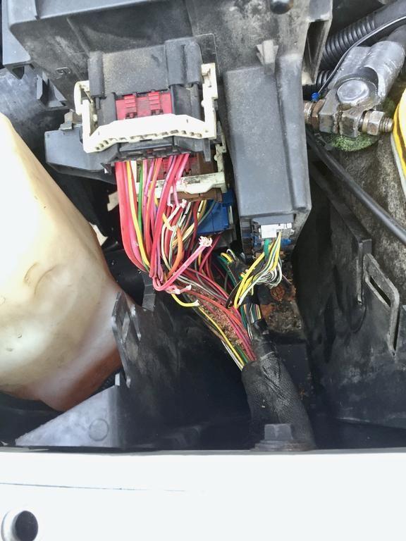

Here’s the culprit. Chipmunk got in there and ate through some of the wires under the TIPM. Nice and cold here in Wisconsin so working on it in the parking lot wasn’t fun but I was able to do some temporary connections with wire and wire nuts to get it fired up and back home. Now I gotta figure out how to do a long term repair. Anyone know where to get the plug ends or how they come apart?
The C1 60 way connector is PN 05135640AB, the C2 50 way is 05135639AA. Be ready to solder and shrink wrap a lot of wires. Also all the wires in the kit are two colors so you need to pay attention to the pin locations.

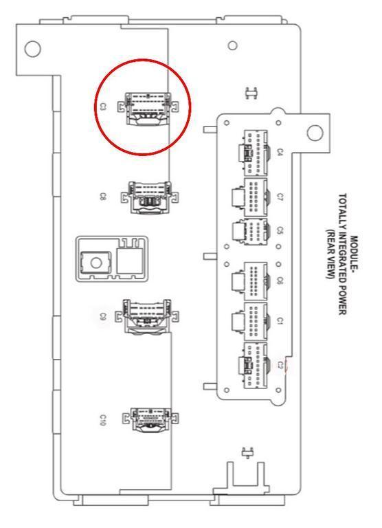

Thanks for info sag2. I found this drawing representing the bottom of my TIPM. From what I'm seeing on my truck I need the C3 connector. Do you know the part number for that one and is this something you can only buy from the dealer?
