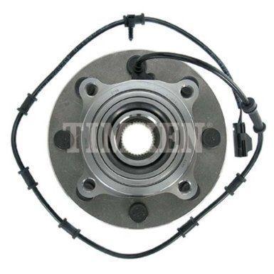

Is it this?
BR930502
If so local parts house has a set for $145. At 190k I think I want to change them before I am stranded.
The Federal Mogul number is a 515061 hub assembly... I can only assume that the BR number you supplied might be the correct one. . but a different brand... .

IMHO, the ONLY one worth buying is the Timken. I get mine from Amazon nowadays.
Many of the other brands simply will not hold up, and that lifetime warranty is not worth a thing after you tear the front end apart several times. Been there, done it.
That price you show above for a pair just screams "Chinese import price fighter" to me.
You have a heavy truck by design carrying a lot of weight on the front axle. Don't skimp on the front unit hub/bearing if you do any long distance driving at high speeds.
Timken Part Number is HA590032.

I recently purchased the timkin unit bearings from rock auto for about 150. 00 each. The same part number mwilson referenced.
