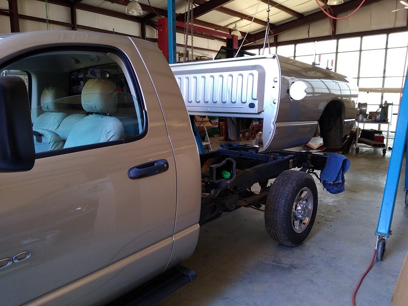

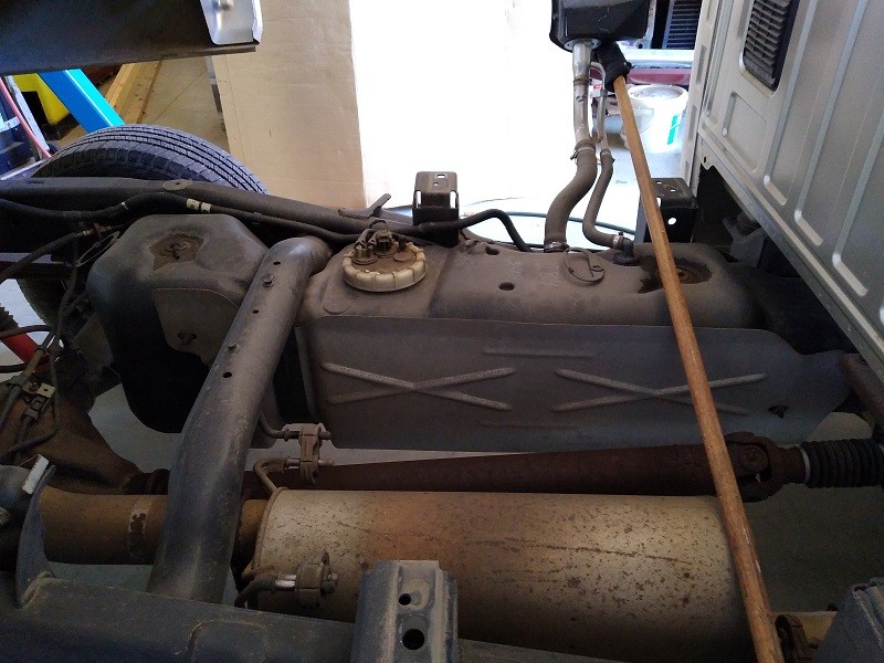

I just pull the bed, much easier. Have done it three times already. 8 big bolts underneath, two screws in each tail light plus the connector, bonding jumper underneath on the front right, three screws at the filler neck. I put a large piece of cardboard between the bed and cab to protect from damage, put some old jeans or similar on the outer corners of the bumper to protect the bed there. Off it comes.

Also avoiding dropping the tank because things are never as easy as everybody says.
Not bragging or anything, but I've dropped my tank 4 times, 2 times solo. If my 52g tank is at a quarter or below I can have it down and out in less than 45minutes solo in the driveway.
Drive shaft, Tank straps, Harness/lines, done. Not at all a hard process. But you are so very right, "Simple doesn't mean easy"
