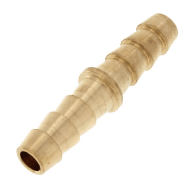

Bypass the DDRP and run the other. All you need is a hose barb union and a couple of clamps. What is this plate you’re referring to?

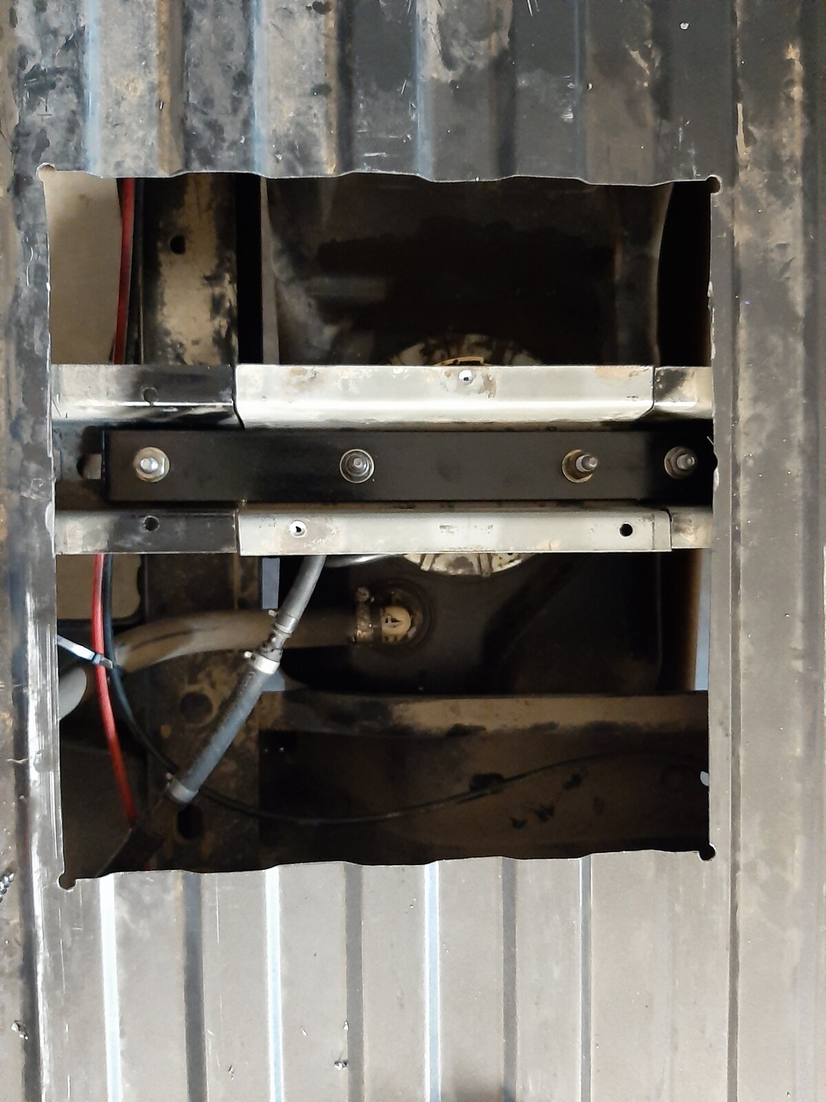

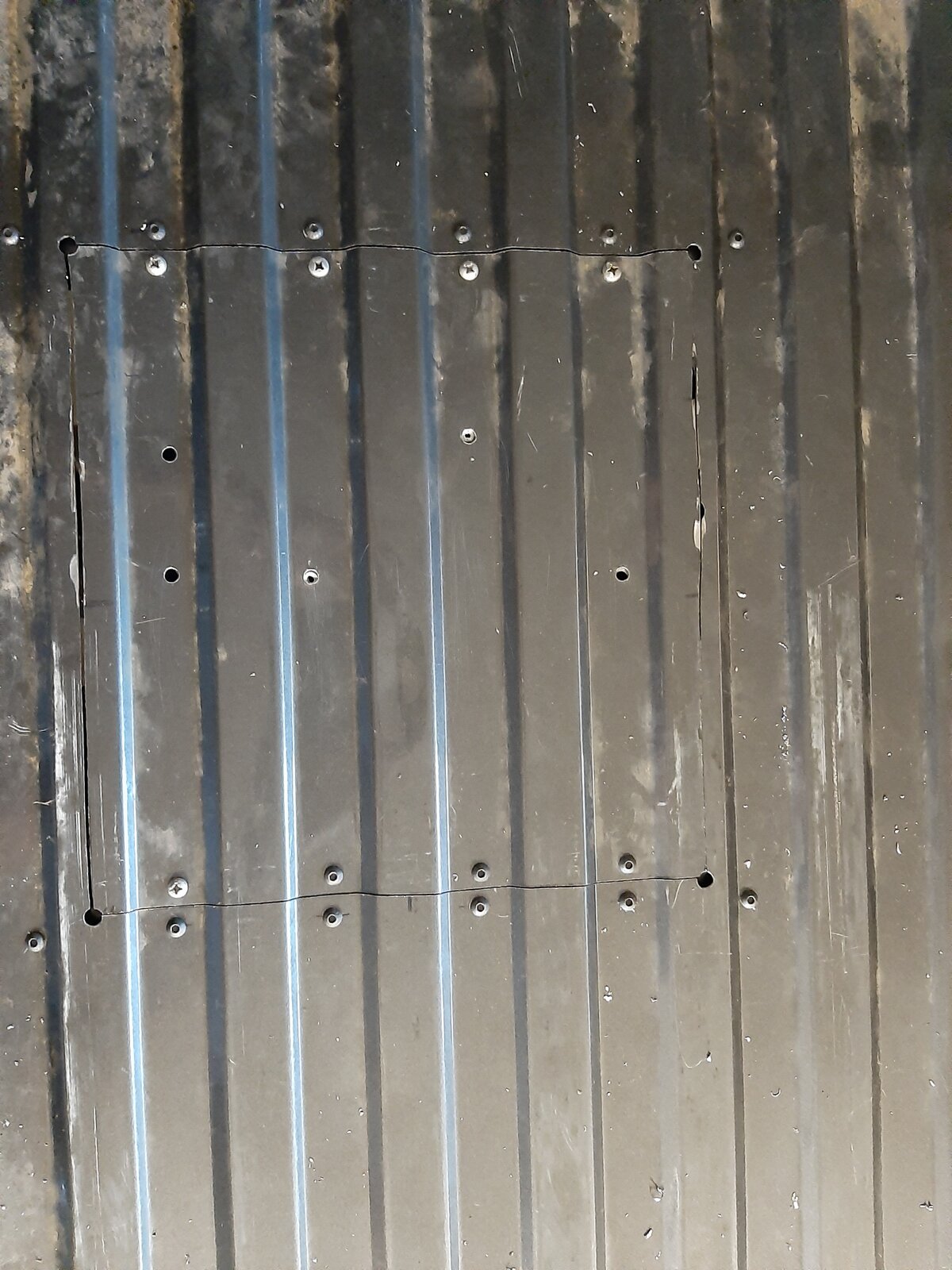

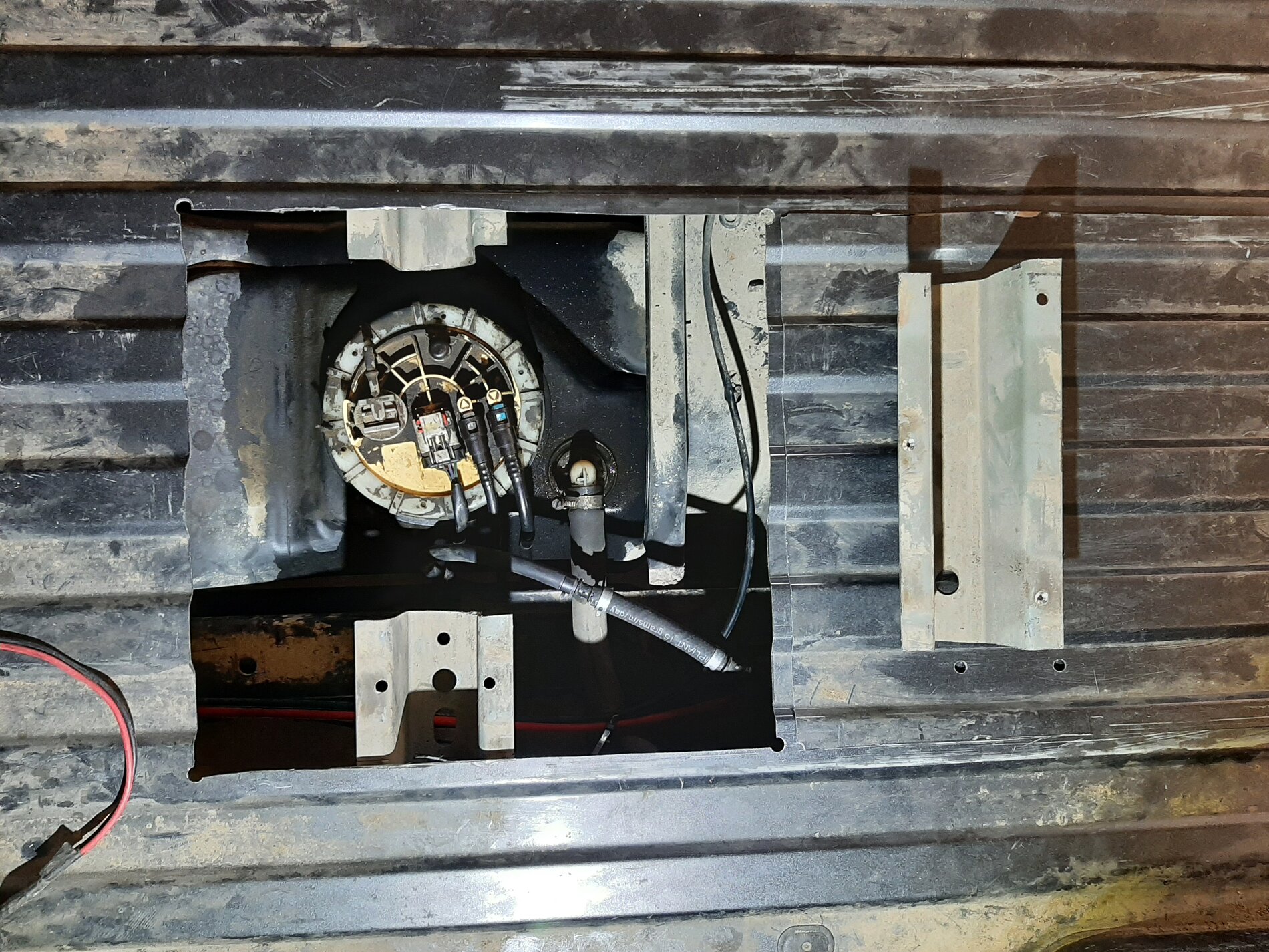

After dropping my fuel tank twice over the last 20 years, I decided to make an access door through the truck bed. One of the best mods I ever did. The actual time it takes to do the mod is about the same as dropping the fuel tank, replacing the basket, and re-installing the fuel tank.
With the modification completed, I can now remove the fuel basket in about 10 minutes. Easy access to electrical and fuel connections, easy to remove the large threaded nut, easy to remove and install the fuel basket. Also, the job can be done regardless of the level of fuel in the tank.

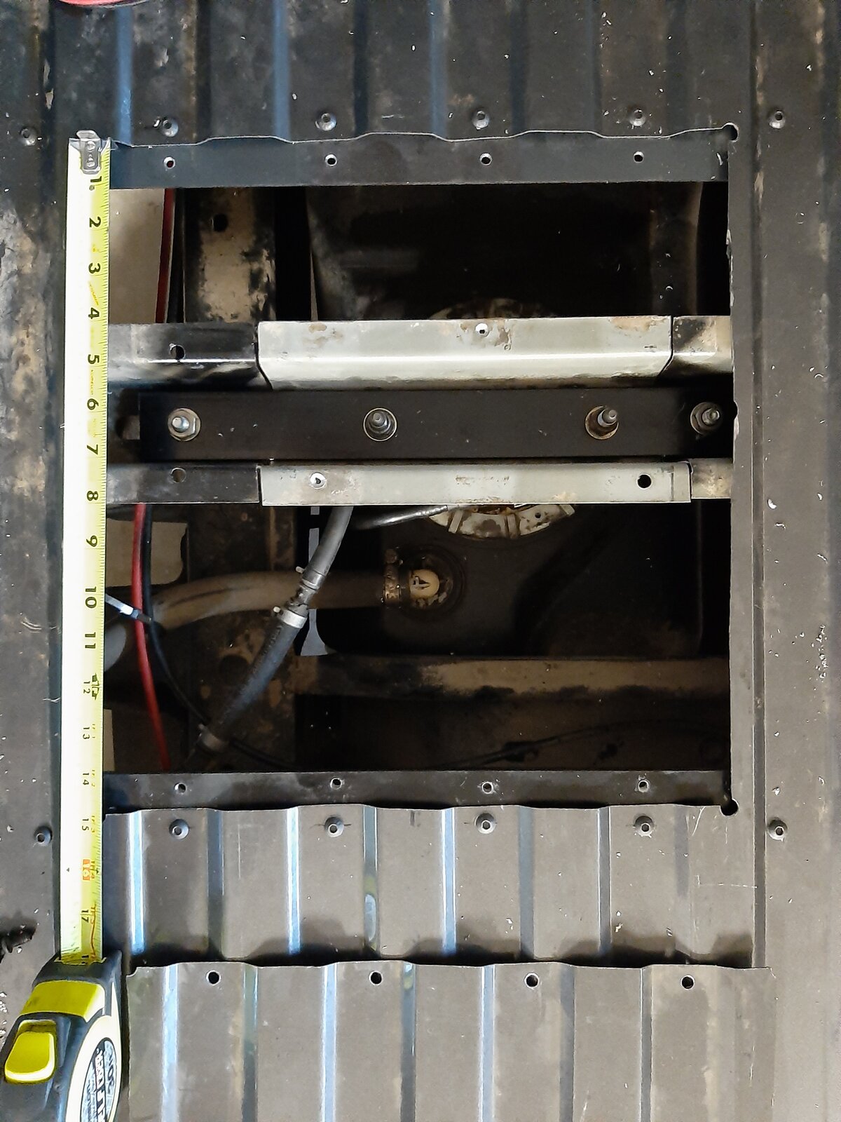

So pop rivet a frame in around the hole then screw the access cover to that ?
Yes, that would be one way to do it. I drilled holes in the frame that I built and used screws and nuts to hold the frame onto the truck bed. I then drilled holes through the cover and drilled and tapped corresponding holes into another part of the frame to screw down the cover. The photo below shows this. Part of the cover is in view by the body of the tape measure.
