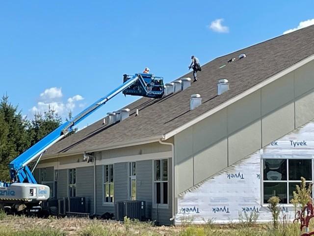

Well my first ignorant suspicion was the Catalytic converter but the local Shop had quoted me $1500 so I planned to DITY when I got home to AL... but now I went ahead and ordered a Magnaflow "Bolt - On" Cat for almost $900 (S&H) as I do have a Sawzall (while working in IA at King of King Lutheran Church while camped on their Parking lot) ....I understand that's all a CAT Thief needs!
