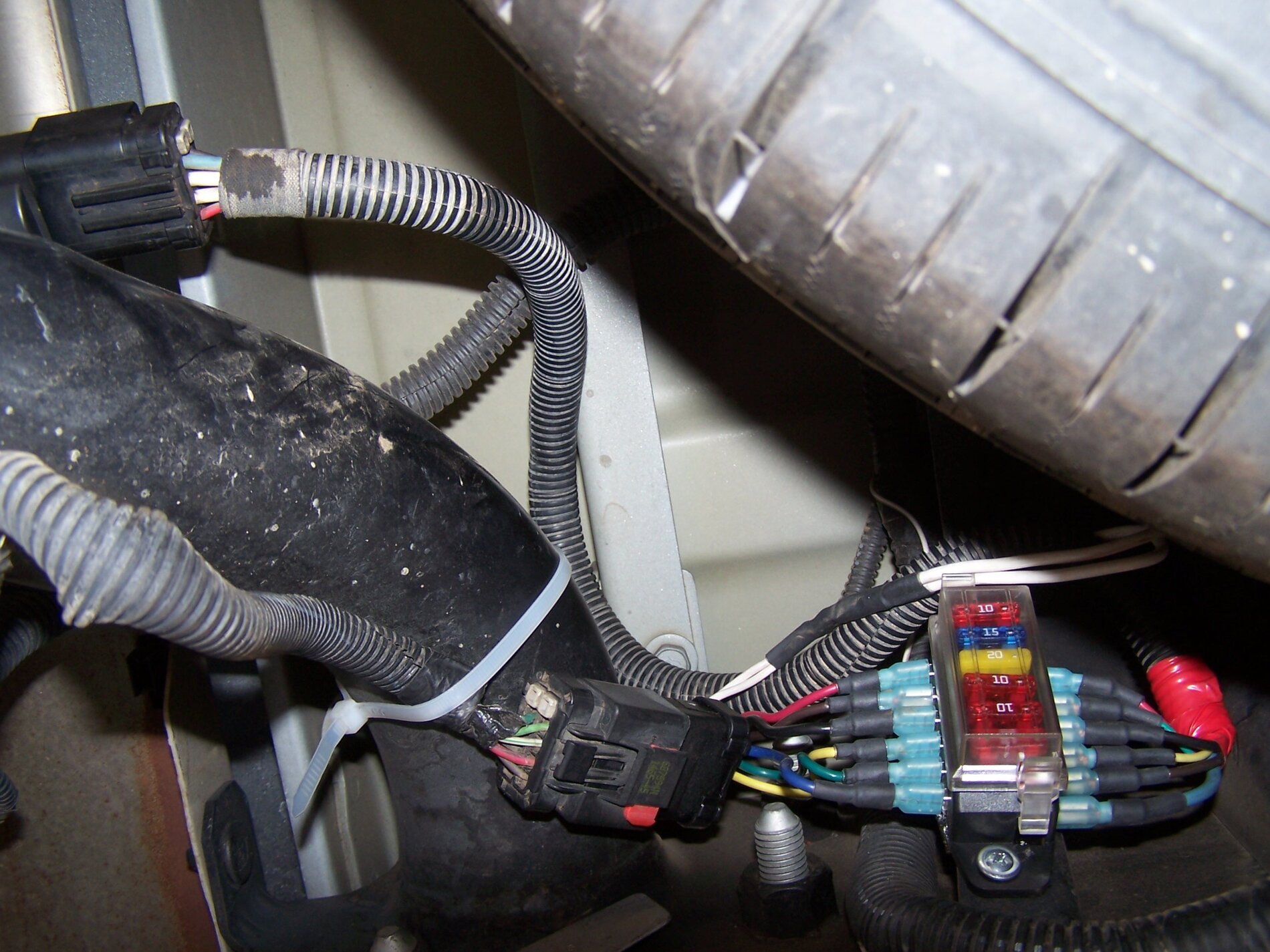

I was working a lot at the time and didn't have the time to put this in, but I had a friend put this fuse block in while I was at work. It's been 15 years and I just replaced a fuse a few weeks ago.

IIRC, there is a plug for a trailer brake controller under the dash. I have a tekonsha P.. something or other. I replaced a cheaper controller, but I just plugged it in (plug and play). I have been running a brake controller since the truck was new, and pulling trailers (first a pop up and now a travel trailer) with no additional precautions and have had no TIPM issues. I have also added various lights (back up liights, offroad lights on a bull bar, and changed my backup lights to projector bulbs, again, with no issues. As my sig says, mine is an '06 as well.
The breakout boxes for the trailer plug are pretty common and will save you the cost of a TIPM. More of a concern if you are hooking to multiple trailers with unknown wiring quality than your own trailer but still a good addition. You get 1 or maybe 2 rests on the solid state control for trailer lights then you replace the TIPM.
