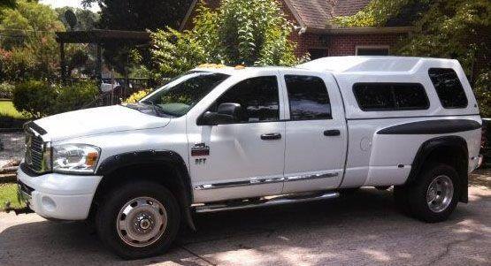

My 07. 5 only has 80k miles on it and getting the best mileage ever. Just added a topper to make our fall Colorado/fishing Wyoming/hunting trip in October. I have too much tied up in this truck to trade now. Maybe when an 8 speed shows up and it will.
