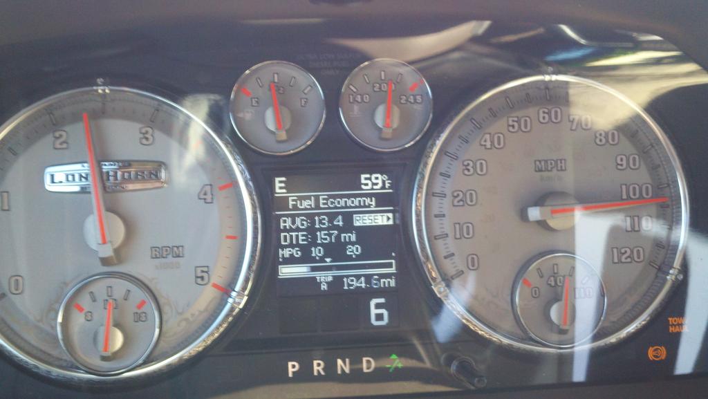

Aside from the very high GCW'S IMHO the biggest factor in 3.42 vs 4.10's is the speed at which you operate while towing. The faster you tow the lower the need for 4.10's, but if you spend all summer in the winding mountains at low speeds the lower gear choices make a huge differenc even at lower GCW'S
A SRW truck with the OEM 18's would only be at 2156 at 80 with 4.10's. Nothing wrong with that, IMHO. That's fewer rpms than I do st 80 now with 19.5's and 3.73's.
