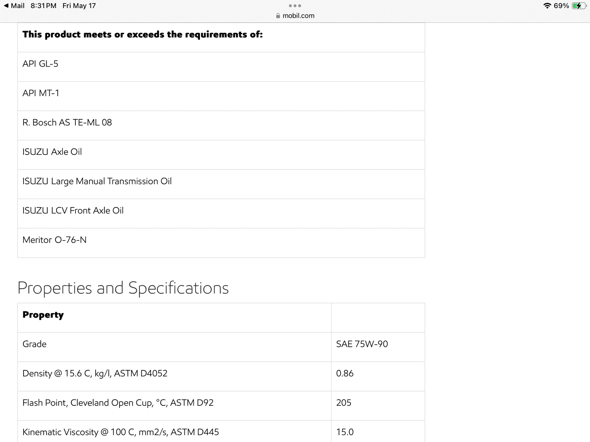

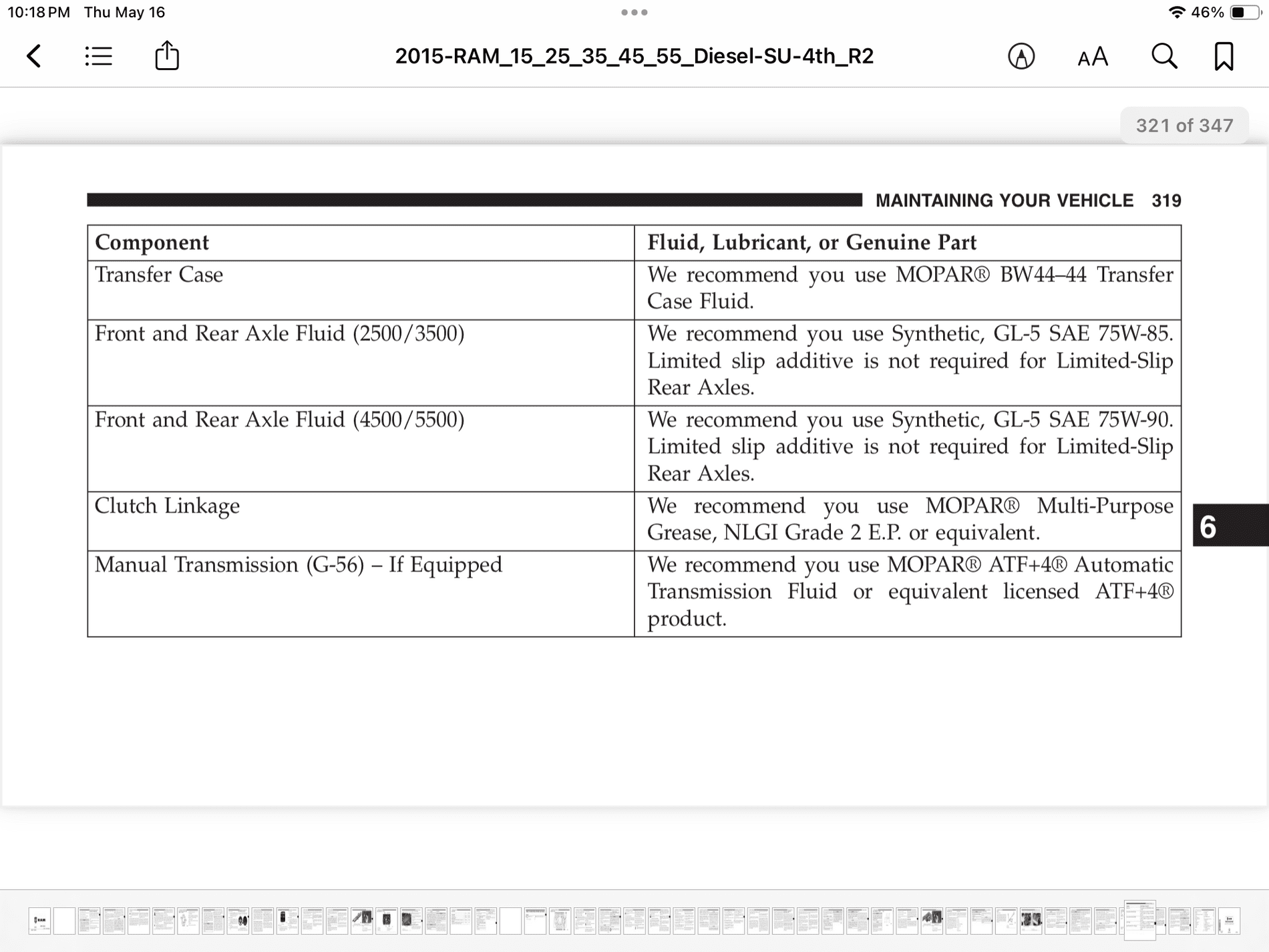

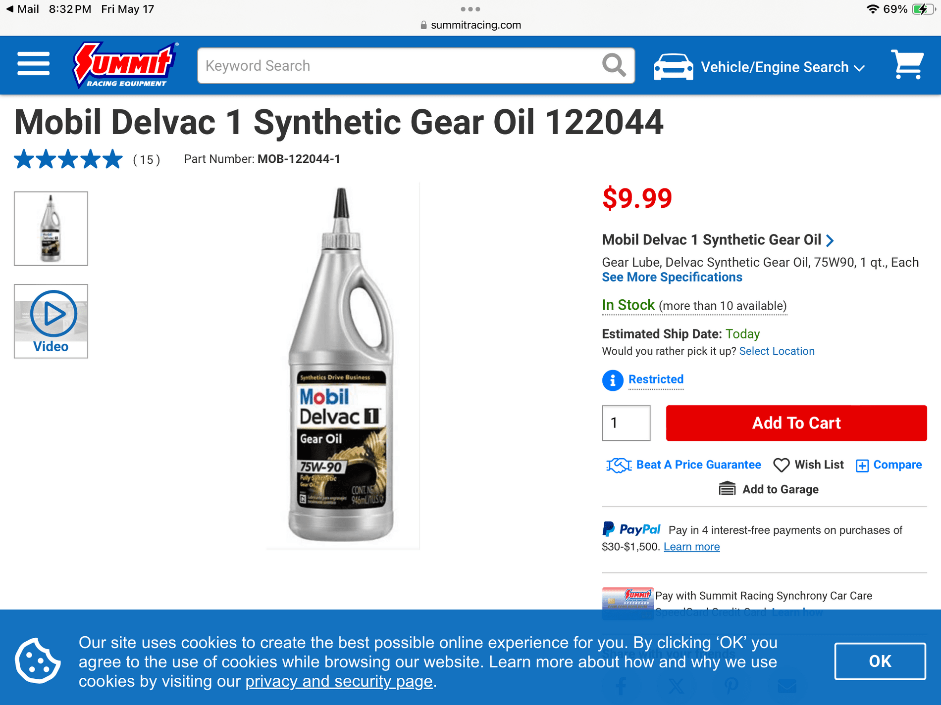

I have a 2015 3500 DRW, CTD, 410 rear with the Aisin trans. Is anyone using this gear oil in there rear? The manual states LS is not needed.
UPDATE!!!
The gear oil I posted about I was getting a feeling of slight chattering from the rear when turning at slow speeds. I replaced the gear oil again but with Mobil 1 75w90 with LS additive and it solved the chattering feeling. So I would say the manual is wrong.

The manual is not wrong, there isn’t anything in the OEM LSD that would benefit from the LS additive. The LSD does not use clutch packs, and that’s what LS additive is for.
