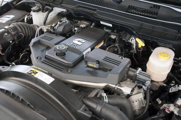

Other articles I've read state that they act as one large radiator and I have yet to see any mention of dual thermostats.
Further, the logic part.....the thermostat controls the temperature as it warms up. If it is closed as the temperature comes up, it doesn't matter what size or efficiency the radiator is because it is not sending coolant through it. ;)
Also, you can see in this picture that the "Y" split in the upper hose comes after the t-stat.

Radiators do not have an effect on how fast a motor warms up, that's what the thermostat is for.
As kthaxton pointed out, they use the same thermostat.
