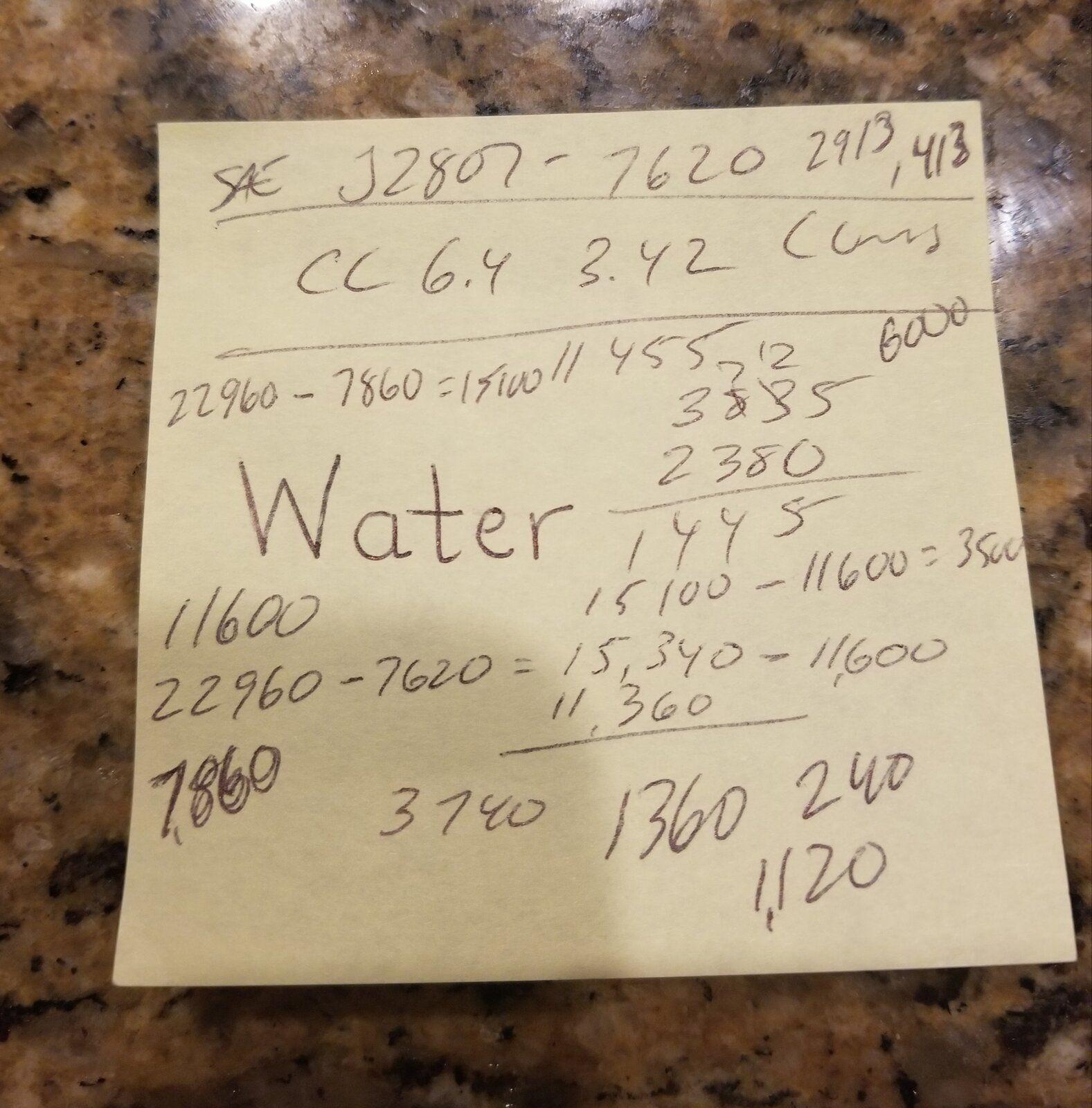

I have a lot of time at times if that makes sence other times I have no time for anything, in this case I saw this thread and had a pretty decent answer based on the J2807 sheet for the 2016MY, using his signature info of a Laramie trim and google used trucks. The 3.42 rear helped me in that "guess" for truck, backed out the weight, tried to get a basic tounge weight/pin weight, which answered the 4k? Rule of thumb can use 25% pin for GN/5th, etrailer says 20%, others say 25%, this is where the real info from folks who haul GN/5th would be great,,,,, if they knew it was GN/5th which they still dont.
Here are my notes after I got the additional weights, my wife asked what the hell is all that and I explained it to her, so thats where the descriptions came in at the top.
As much as you will always get the back and forth which is great entertainment value for most of us.
I really should post this as a thumbnail to drive home that point, but will not.
Give some additional info, answer some of the questions you will get accurate info and if its not exactly what you want to hear.
I did a draft of this about 20min after the post was up, no I dont tow heavy, but these are real numbers off the spec sheet for that MY, if you need and know a specific person to respond send them a PM.
And I know he will be fine towing, is it within the limits of the ratings I thought it was going to be close from the start.
