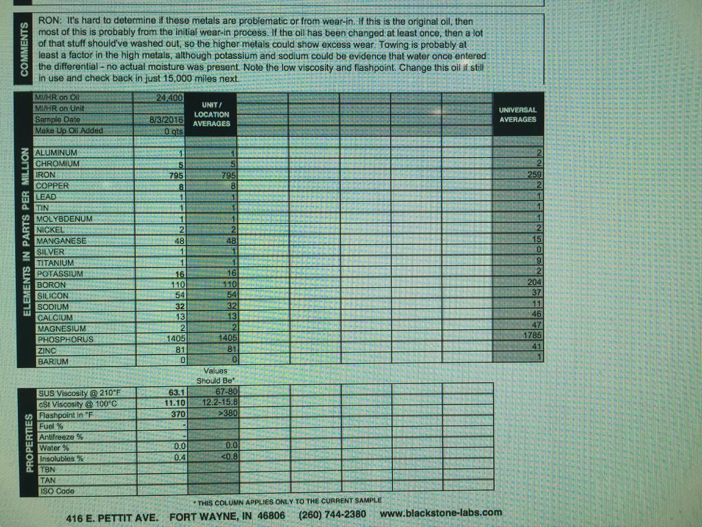

I did the rear diff change a couple days ago. I sent a sample to Blackstone, waiting on results.

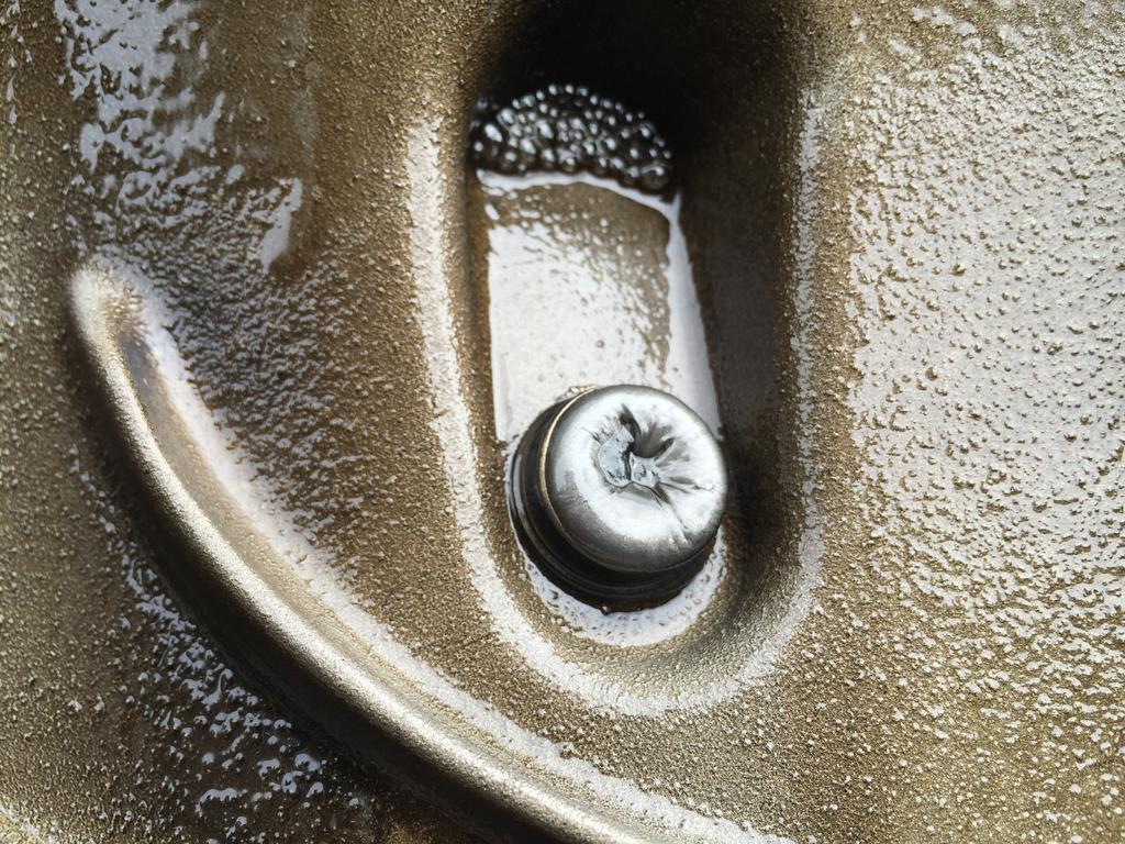

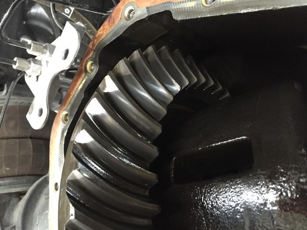

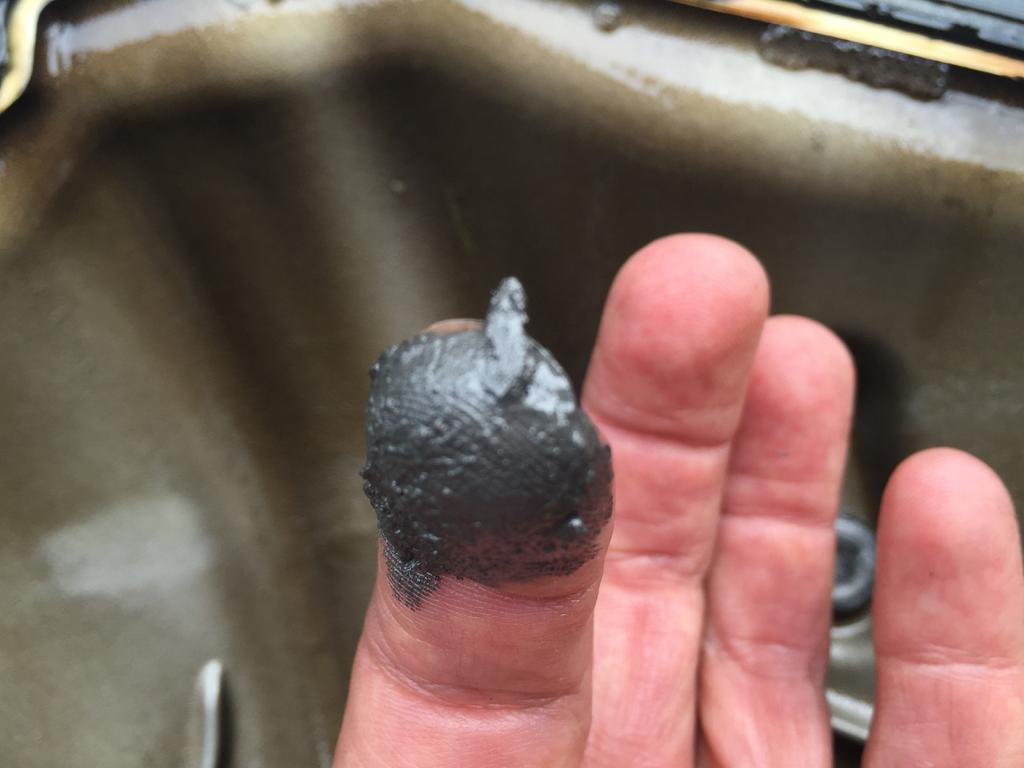

I can tell you I have never seen GL come out this dark in 24K! There was virtually no wear metals, the ring gear teeth were polished in appearance. My 11 HO towing WAY more miles and at least 50K on it when I changed at 65K came out golden brown and there were still machining marks on the teeth. I ran AMZ/OIL 75/110 in the 11 and that is what I just put in the rear and front of the 15.
The inside bottom of the diff housing was spotless.
Here are a few pics. I will post Blackstone results when I receive them.
Here are the results. For sure needed to be changed! This was the first change at 24,400 miles. I have over 8K towing a 23K 5th wheel.
Will be interesting to see if the grabbing is gone with the new lube.
