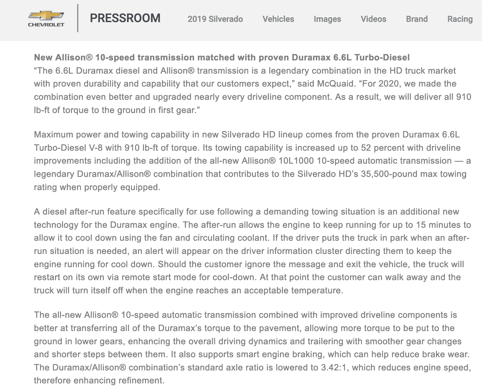

Never been a GM truck fan, but it sounds like they are doing a good job, I like the cooldown feature. I think some folks under appreciate the need for a cool down after a hard run.
TM has to be in there, most likely ramps up to xxx lb ft. That's still pretty impressive especially given the low low first gear a 10 speed trans will have.
I wonder if this 910 ft-lbs to the ground in first gear talk is a play on works marketing hype. A Honda civic probably puts 910 ft-lbs to the ground in first gear due to the torque multiplication of the first gear in the transmission and the diff after that. Maybe????
Sounds more believable, ramps up-to...under the right conditions and parameters.
Agreed, still impressive with what is surely a very low first gear.
Good question, though it would seem strange (or not perfectly truthful) for them to use the exact same 910 number.
I dont think that the 1 Gear will be significant lower then it is now, what should that be good for, no need for a granny gear.
They just splitted every gear in two and thats it.
More gears in the middle and upper range means fuel savings as the engine can run most of the time in his most efficient rpm range. And fuel savings is what they want.
With 10 gears to work with, I think 1st will be a lot lower. Here are the 6spd ratios for the Allison 1000:
1 2 3 4 5 6 R
3.10 1.81 1.41 1.00 0.71 0.61 (06+) 4.49
I can't find anything on the new 10 spd. but here is some info on the 10 spd for the 1/2 tons.
Model 1 2 3 4 5 6 7 8 9 10 R
Hydra-Matic 10L80 (MF6) 4.70 2.99 2.15 1.80 1.52 1.28 1.00 0.85 0.69 0.64 4.87
And that will be exactly the same as our 8HP70 Transmission.
No granny gear.
Agreed, no 'granny' gear, but such ratios/terminology were generally reserved for manual transmissions.
Something like 3.0:1 is lower than traditional first in old three-speeds, and even my '06 V8 Toyota 4Runner with 5-sp A/T has what is/was considered a low ratio first, at 3.52:1. Works well.
Ford's F150 10-speed has a first ratio of 4.69:1, second is 2.98:1, and moving first into the fours makes sense, as it really helps start a load moving.
But we shall see...
No granny gear.
But your comparing an 8 speed in a completely different application instead of the previous 6 speed in the GM HD pickup. Compared to the 6 speed first gear the 10 speed first gear almost certainly will be lower than anything in the current HD market .
Yes, a supposed beefed up version. I don't know if they left the gear ratios alone or not for the HD version.
8HP gear ratios
1 2 3 4 5 6 7 8 R
4.714 3.143 2.106 1.667 1.285 1.000 0.839 0.667 3.300
5.000 3.200 2.143 1.720 1.314 1.000 0.822 0.640 3.456
I'd say that those are very low first gears (by any traditional/historical measure) for an automatic transmission. They probably pull and work well.
My 6-speed manuals are still my preference.
And what is the benefit of a such a low 1 gear on truck that shoves 1000ft/lb into the transmission?
I would have missed that decades ago in our under powered euopean vehicles, but here?
I never felt that in my old 48RE equipped Truck the 1 gear was to long, the problem was and is 3-4.
Less stress on the driveline would be a good start, another would be less heat load from the torque converter (less fluid shear).
I suppose if you drive like a tool and stand on the throttle from a dead stop these benefits would be mum, but for the average driver I can see the advantages. Especially when towing off the hard pan, I've had to grab the low side of the transfer case quote a few times because 1st in 2whd or 4 hi is a little too high for those situations.
