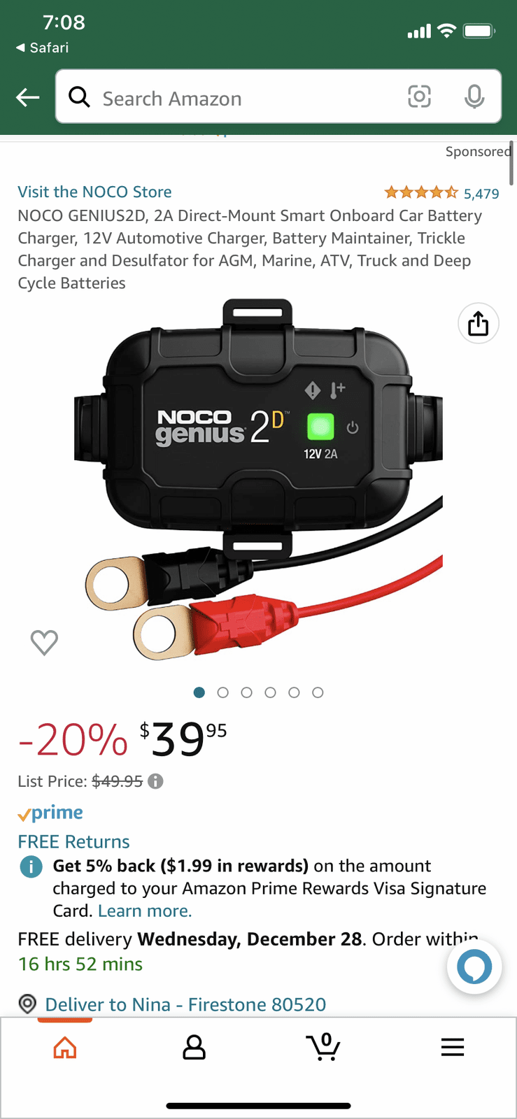

I did some quick searching and found this one. Looks like it’s meant for this exact application. Gonna order that up and install when I get it back. May try to run the cord parallel my block heater for easy plug ins.
Yes that’s what it’s for. I didn’t install mine on the truck, I use a 10’ extension and keep the charger on the wall near the plug in.
