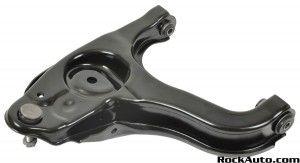

Hopefully mine will go smooth, as far as I can tell mine are all OEM in the original control arms, no tack welds or rivets in sight. The only brand I can get locally is Moog at full retail, so I ordered the XRF package deal for the 94-96 trucks.
I just couldn't go for the Dorman or Moog loaded control arms, they look way too cheap. Raybestos had poor reviews on Amazon and were out of stock, ACDelco lower control arms were priced near OEM MOPAR. So, ball joint press session planned this week using XRF joints. Got the penetrating oil applied today after cleaning off all the mud and grease and rust.

It was not easy, my first time. But, it will be a simple job if I do it again. I probably would get new upper arms next time, that press in upper ball joint hole wasn't as tight as I would expect. But they were not loose using the XRF's. Just didn't feel that tight when pressing in using my long handle ratchet, the lower joints were almost twice the effort. I figure it will get too loose for the uppers if used a 3rd time. Maybe just weld in the next set or replace the arms totally, the bushing will be totally shot by then anyway.
The XRF joints were very tight, could not turn by hand. Nicer quality than OEM, heavier, slightly longer and greasable. Not bad for $189 shipped, cheaper than the Moog Problem Solvers from Advanced. And only about $30 more than the Moogs on Amazon with the awesome price. Amazon was 1/2 the price of my local parts stores, but the XRF deal was too close in price to pass up off eBay. The Tire Club had quick shipping and they answered my size questions via email.
If you have a pre-96 2wd, make sure the lower ball joints are original. Some have had the lower control arms changed out to post 97 versions which take a larger ball joint. Thats why some shops/dealers have welded in the smaller pre-96 ball joints in the later control arms. And some are riveted, so make sure you know what you have before ordering parts.
