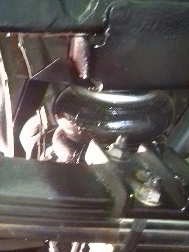

Full air bag setup with 2.5 g tank and in cab controls was about the same cost as the factory option. I am more than happy with the current setup!!! I run FULL RAWR full time RVing at 9,750#. Truck sets the same unloaded or loaded. Rides GREAT either way.
First pic old RV about 8,500 RAW. All pics ALT ride.

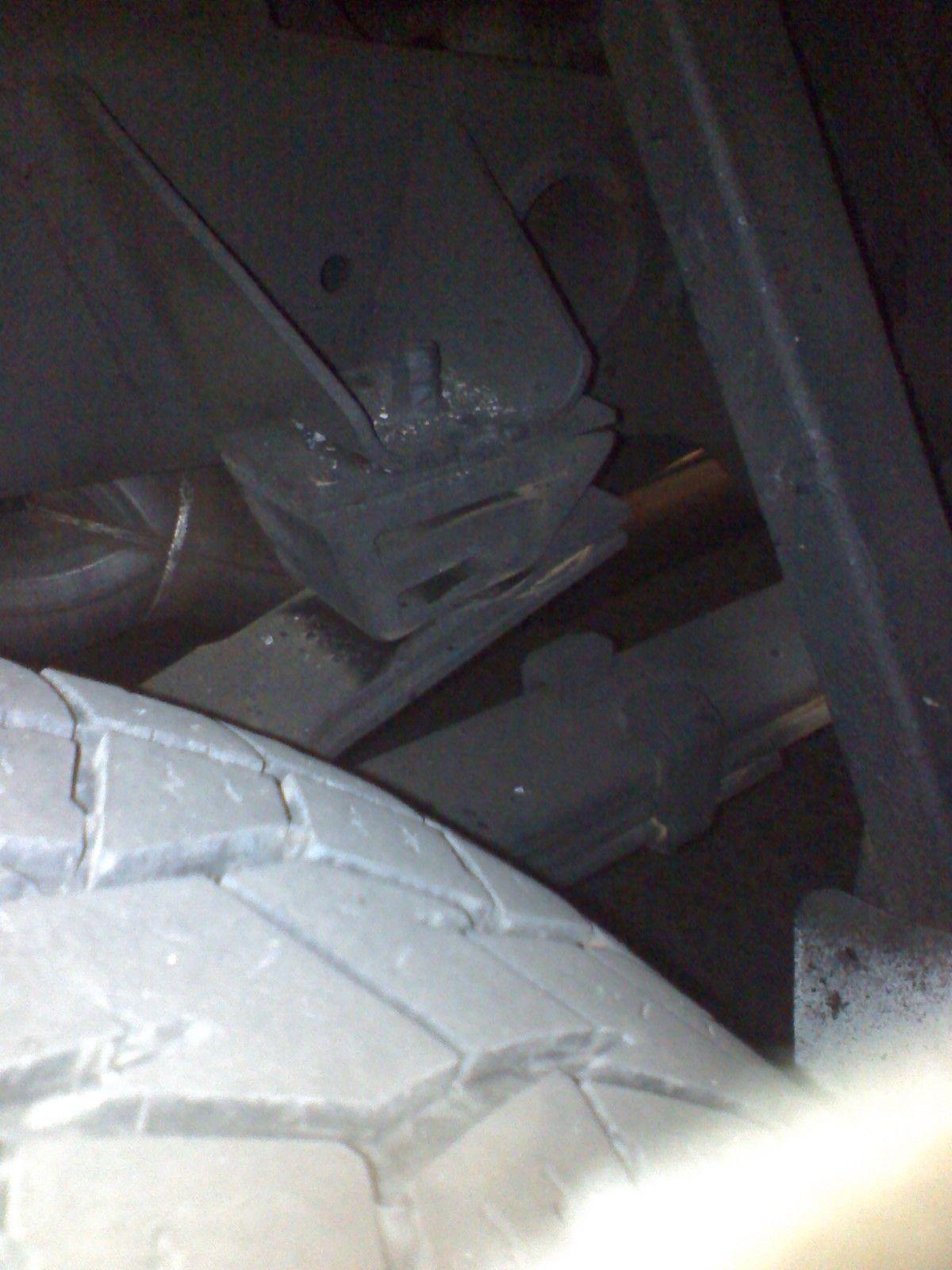

The 2011 DRW had the 2003+ 6101 primary spring + the additional Helper/load springs, it had to travel 2.5" before the helper springs engaged, The 2013+ SRW 3500 has the 6102 spring W/O the helper/Load spring, its individual leaf Springs are 1.25MM thicker than the 6101 spring leaf primary, So 6102 spring is stronger than the 6101 until the helper/load spring engages. 2.5' is a considerable amount of drop.
6101 spring with Bump stops and Helper/Load spring engaged.
If I could I would order 3500 SRW with 6101 Plus the helpers/Load spring setup, and add bumps stops or Air bags, You can only get the SRW with 6102 Spring and No Helper/load. ugh.....

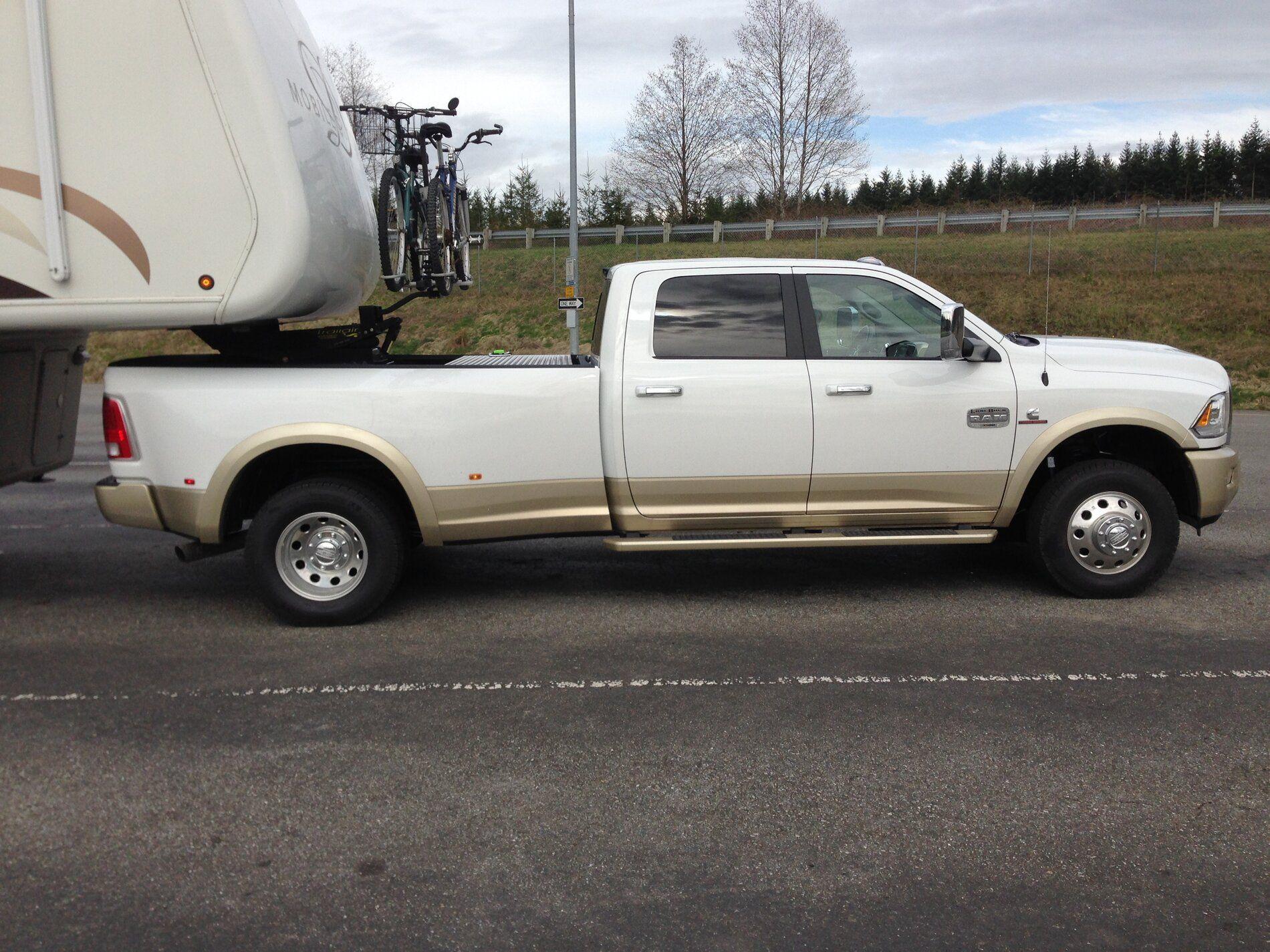

First pic 2011 with BAGS. The truck has almost 5k load on the rear. Looked like that without bags also. Aired just enough for the benefits NOT to raise as it rode on the overloads as it should. Great ride. Also had Bilstien 4600's.

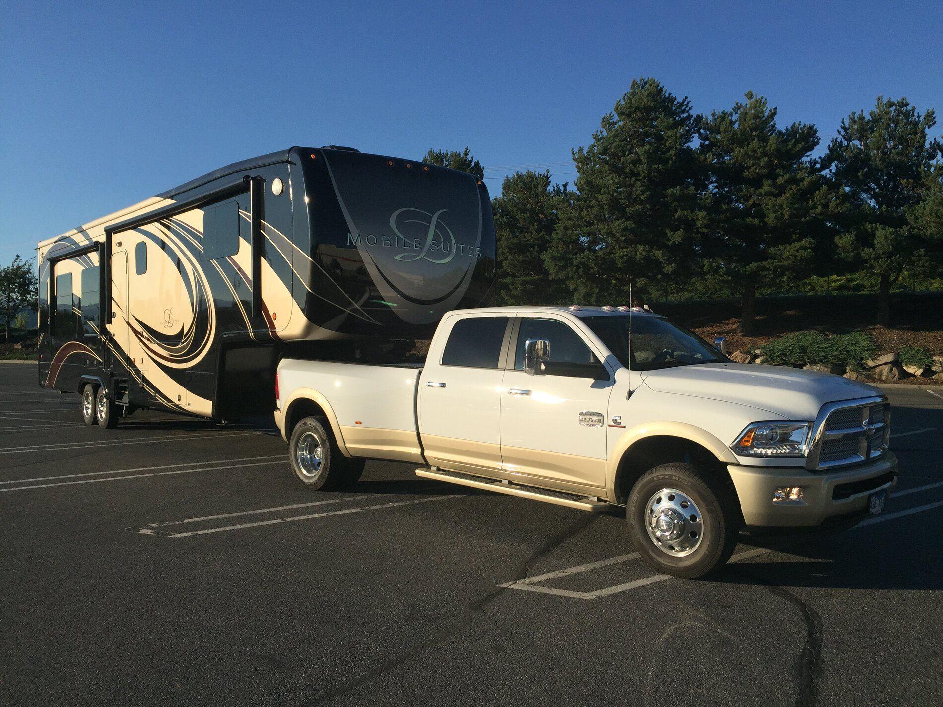

Second pic 2015 OE rear air. Truck has just over 6k load on rear.
