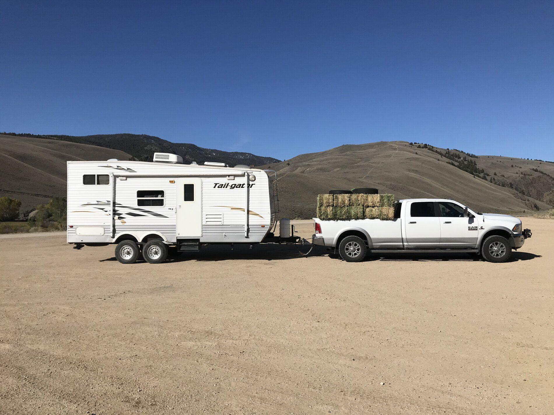

This is simply not the case with the OE Auto-Level system. The OE springs are softer, better overloads, and the height settings are optimal for proper pressure at any load I've used... empty thru 7.2K RAW.
There is simply no need to adjust the bags beyond what the truck does itself. The ride is comfortable, VERY stable, and all I do is press ALT when RAW exceeds 4K lbs.
This is this last weekend. 24K GCW, with 7.2K on the rear axle. 265 miles of winding mountain roads, 65 of which were dirt and ROUGH. It handled the trip noticeably better than my 05... all at the cost of about .5 mpg.
