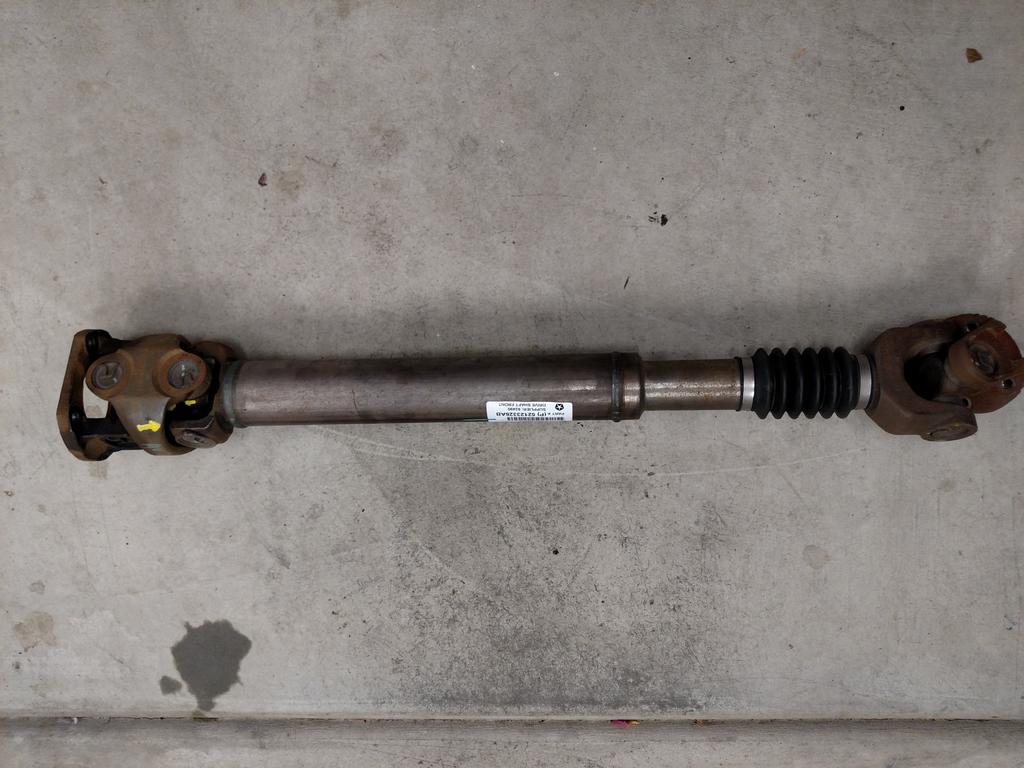

I was at a friend's shop once (he does a lot of diesel performance in regards to pulling trucks) and it's even a booooooooger to find the fitting with the driveshaft out, laying on the floor (he had a couple out of 3rd GEN & 4th GEN trucks in his shop).
I was shocked at how long it took me to find it the second time. I knew it's approximate location and what to look for, but I must have still turned that shaft around 20 times before finding it.

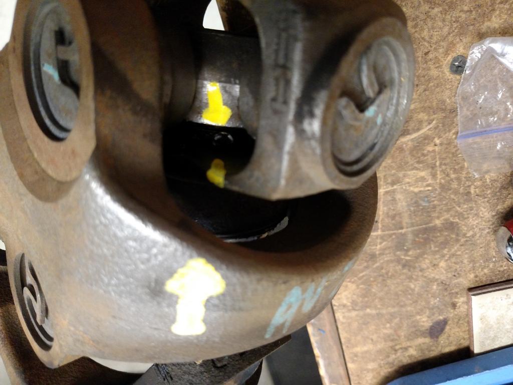

FOUND IT! I finally found the front driveshaft grease cup on my truck! After looking closely under the truck for about a half-hour, I was ready to announce that my truck must be one of those trucks WITHOUT the grease cup. However, just to be sure I decided to REMOVE the driveshaft. My plan at first was simply to remove the FRONT U-Joint bolts, drop it down and allow the back to pivot…. giving me more room to look. This idea didn’t really help. So, okay, 4 more bolts and I had the whole thing out on the bench for a look…… STILL nothing. And then….. there it is! DAMN. Okay, clean and grease with my new grease gun adaptor kit. Even on the bench it was difficult to find and perform the service. I used a paint pen to mark the location for next time. Then cleaned everything up for re-install. Prior to taking the driveshaft out, I index marked the joints to the trans/diff flanges….. so that I could re-install exactly as it came from the factory. Honestly, I don’t see how this service can be performed in-vehicle…. especially with the transmission support cross member location….. its right where we need to access the joint grease cup. The Manager at my local Dodge Dealer was the original owner… I bought the truck from him at 25k miles….. he had all the service records from the dealership….. from the looks of it, I would strongly doubt the dealership had EVER greased this joint. Now that I know where to find the silly thing….. I may try and find a more of a needle tip (I found one at Tractor Supply for about 5 bucks) and a small, one-hand grease gun….. perhaps, I can do it without removing the shaft. I am really disappointed that a seemingly critical service item is in such a poor location. I know of several trucks in this area with over 100k miles on them…. and I’m sure this service has not been performed….. EVER. Bottom line from me…. If your truck doesn’t have one…. keep looking until it does.

All the 4x4's have them. It will be very hard to see. Laying on your back with your left arm facing the rear of truck and of course your right facing the front. It's not a zerk fitting. It's more like a counter sink that you would make in wood with a tiny ball bearing under tension to keep the grease from flying out when spinning.

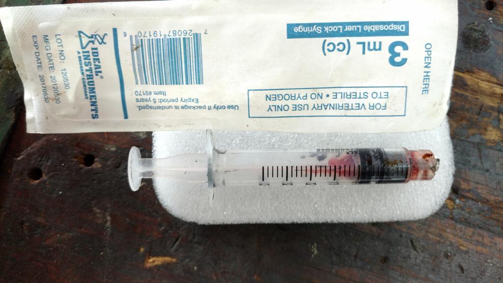

I got this idea from another member on the Dodge Cummins forum. I use a 3ml syringe and a 16ga needle.

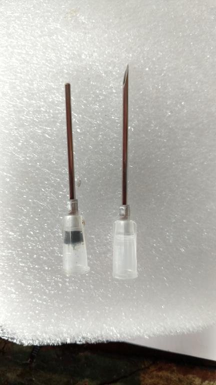

Below grind down using a grinding wheel or a belt sander to grind down the point. Do not cut or you will crimp the end close. Rightside needle is before grinding and bottom is ground down.
On the syringe remove plunger and fill with grease to the 2ml line. It does take some effort to push plunger. Insert needle about 1/8" into fitting. Repeat one more time.
I will confess I pushed mine in to far and the ball bearing is now somewhere inside the joint. That was 45k miles ago. I was assured my issue will not harm anything.
I purchased syringe at Tractor Supply, I'm sure that any pet store that handles farm animals will have the syringe.
