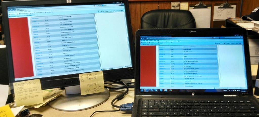

Just took a minute and checked a few things, sorry for the delay.
Have both engines up on separate screens, if you have any questions please ask now.
Pistons and Rods are the same
Cylinder Head is the same.
Flywheel Housing is NOT the same. You will have to change it from what I am seeing.
You are going to have to treat the purchased engine as a long block and change parts accordingly I believe.

Thank you Mike! Will do. Same lift pump, injection pump, and injectors? I don't know how I will mate the new engine with the old harness yet. I just need to get in there (will do on Sunday) and will post more questions then. Thank you.
Injection pump and injectors are indeed different, you will have to change them. Seth tried a truck VP-44 instead of a dodge VP-44 one time and it did not work out well. You are going to have to change just about everything on the outside of the engine over. The fuel transfer pump is the same at least.
Oil Pan and Sump Tube are different as well. Those will have to be changed out. Dodge is rear sump, the donor engine is front sump.

Sign up for the free Quickserve using the ESN from the Ram. You can do screen shots of the manual, I have done that in the past.
As far as genuine Cummins parts you should have the best luck at a Cummins authorized truck dealer. Where in the US are you???
Not fair I know, but I can do two at a time....
