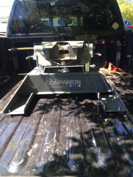

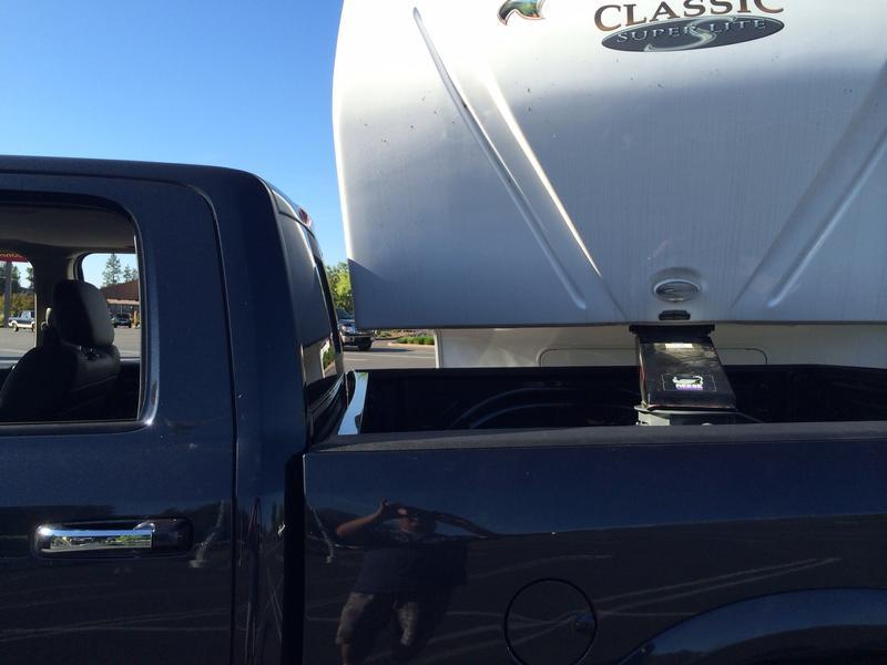

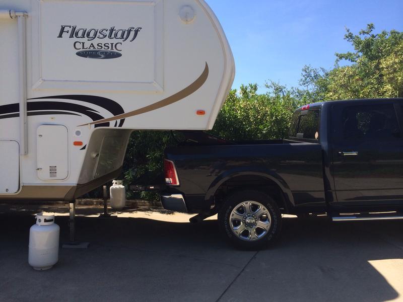

I just installed the B and W companion and it works great. I have a 2014 2500 with the coils. This is my 3rd 5th wheel hitch and the B and W quality is much much better. I have a short bed and did not buy the slider. I placed iin the rear holes, the pin hole is just behind the axle centerline and with my moderately extended pin box, have 2 inches of clearance at full 90 degree turn.
So far the coils are great. Less sag than my old 2003 2500, approximately 1-1/2 inches. 10k trailer. And only one hole in my bed!!!! Could not be happier, with the truck and hitch.....
