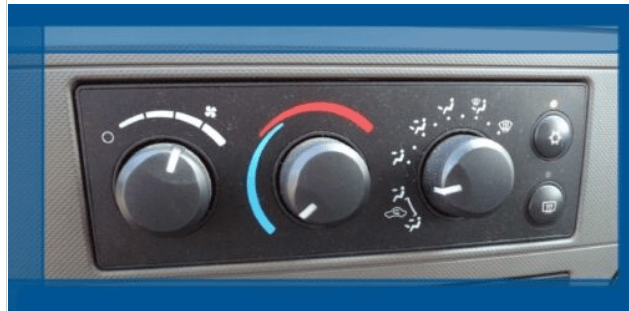

You don't say what door position is selected on the control panel. If the selection is like in the photo below, then most of the air would come from the vents and the rest would go to the floor. This would be normal. The photo is for a 2006 - 2007 Dodge Ram.
- John
