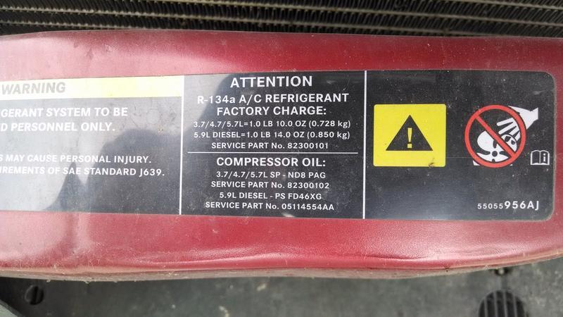

This is on my 2006 and does specify a different oil than PAG if equipped with the 5.9 Cummins. A 2002 may not be like that, see if you have a tag under the hood somewhere.
Mike.
Mike.
Mike, that decal is a little confusing, at least to me. Would the Diesel equipped unit really use a different oil? Or are the different part numbers for the oil indicating a container of oil with the correct amount of oil for the different systems (with enough 134 in it to dispense the oil into the system it)? bg
I think it a result of a different compressor being used with the diesel. I have to stock three different oils at work due to different compressors being used in R134A systems. We use PAG the least. Daimler truck usually specs Sanden compressors so I believe that bdaugherty is correct in his post above.

I have to run over to the shop today, I'll try to remember to check the oils in stock to find the content. Maybe it is simply the viscosity.
Mike.
