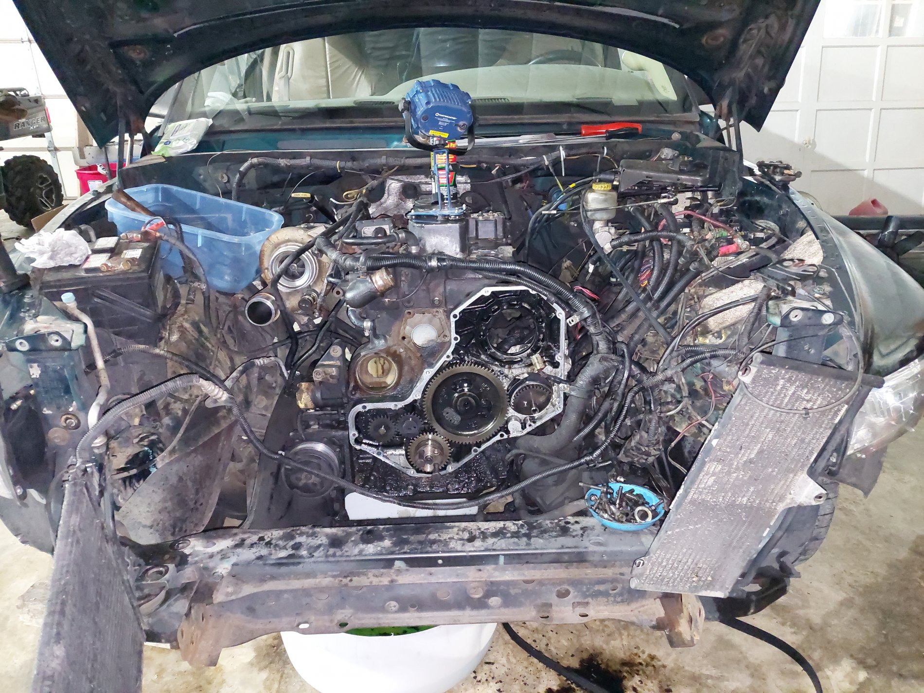

If a guy wanted to have unfettered access to the front of his engine (cam swap, etc.) can the condenser just be gently moved/rotated aside and supported, or is complete removal required as the FSM states?
I need to reseal the timing cover, oil pan, and vacuum pump, and am hoping it's easier to do with the front cooling devices removed.
You can do it. This was my ‘98.
