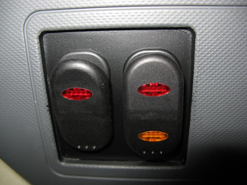

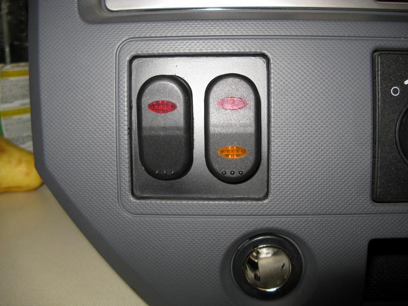

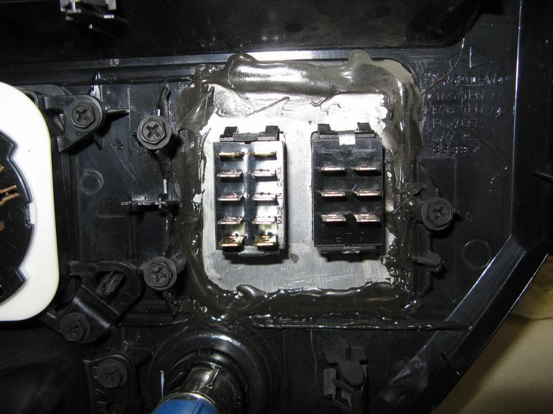

Here is where I mounted 2 rocker switches. My 6 speed, 4x4 truck had two little compartments on both sides of the climate control switches. I pulled the center dash face (what a PITA!) and removed the left compartment cubby. I used a Dremel tool and flattened out the small plastic flanges around the hole on the back side of the center dash face. I cut out a small piece of aluminum sheet into a semi square that fit now across the opening. I then sanded the back side plastic on the center dash piece and the aluminum with some coarse sand paper so some JB Quick weld would stick to both surfaces. I carefully applied the JB weld so it wouldn't squeeze out into the area you see and then smeared the rest across the back. Not pretty but it works. After a day to set the JB weld, I measured and found the centers of the panel and switch centers. I cut out the rectangles out with a Dremel and fit the switches.

If these ever need to be removed then all I need to do is to replace the center dash face with a new one.
