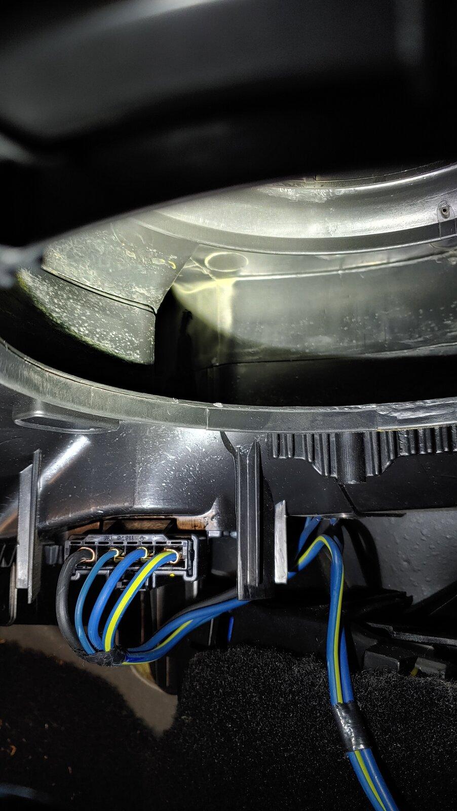

I just dropped mine to take a look. Not much room in there at all. Was able to stick my phone up in there and get a picture. Not horrible for 65K miles and no filter. A little gunk on the lower left, going to be difficult to get to especially since you can't see up in there and it's a small opening from the fan side
So that's with your blower motor out? I might just pull my pass seat so I can get extra access. Ive got really wide shoulders from playing rugby for a long time and even with my seats all the way back its hard to get angles on things.
Yes. Took me all of 2 minutes to take it out. Just pop the liner out from the underside of passenger side dash (if you have one) and 3 8mm screws holding the fan in. Pulling the seat would complicate the procedure 10 fold but if that's the only way you can get in there I guess you have to.

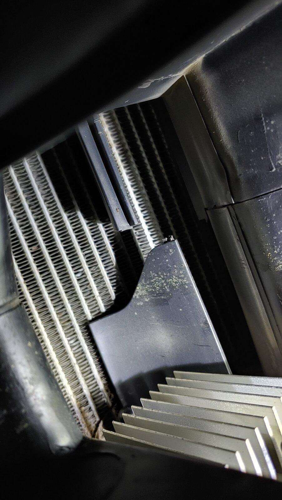

Here is the access to the evap in the back corner. It's a pretty small opening and no way to see in there other then taking a picture with my phone.
