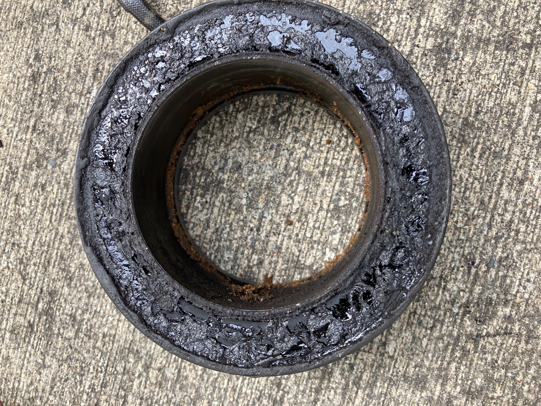

Can you post a picture of the clutch? Otherwise is the paint burned off, blue metal, or melted magnet look?
If the clutch has been slipping it will burn up the magnet coil. Some may have a one time thermal fuse in them.
The clutch slipping can be from a shaft seal oil leak, compressor locking up, clutch wear. A slipping clutch is likely to hurt the shaft seal.

I installed the coil/clutch yesterday. The coil was literally cooked and the clutch assembly fell apart in my hands.

Any ideas for what would have cooked the coil? It is literally flaking apart when I touch it.
There was black, sooty residue inside the coil, clutch & pulley assembly and while pulley bearing rotation on the original pulley wasn't as easy as it is on the new pulley, it still turns fairly well with 2 fingers. It appears that the black residue is from the coil.
