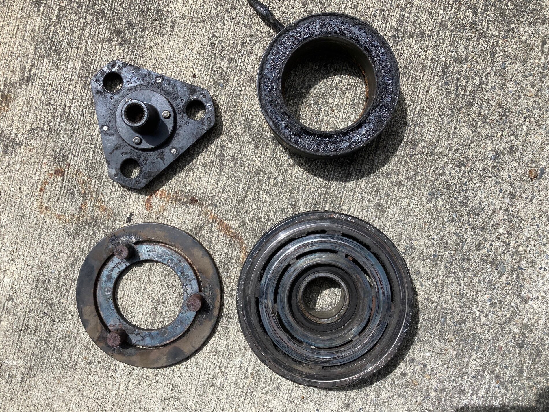

Definitely got hot.

Trying to figure out why the coil and clutch got cooked.
Is it possible for the coil to get weak, allowing the the clutch to slip?
It never gave any hint of going bad, no funny noises, bad smell and always had cool temp

Looks good to me. The clutch is metal to metal it wears and gets loose. Surfaces have a blue color indicating overheating due to slipping.
My manual has this burnishing process for a new clutch. I do not know if it applies to your clutch brand. I did not do it on the Sanden clutch I replaced because I did not know about it at the time.
"After a new A/C compressor clutch has been installed, cycle the compressor clutch approximately twenty times (five seconds on, then five seconds off). During this procedure, set the A/C-heater controls to the A/C Recirculation Mode, the blower motor in the highest speed position, and the engine speed at 1500 to 2000 rpm . This procedure (burnishing) will seat the opposing friction surfaces and provide a higher compressor clutch torque capability."
Improper air gap due to wear etc. Air gap too close and dragging lightly. Bad fan clutch allowing high head pressures that overcame the holding power of a worn or oil contaminated clutch, compressor starting to lock up, liquid slugging on startup and clutch isn't able to get the compressor spinning... Once the clutch isn't able to spin the compressor it burns up really fast - like an on ramp to a freeway in distance fast. Had a vehicle that would kick out the compressor on WOT and then expect it to kick the compressor over when you got out of it. Worked till the one time it didn't and I cut the belt as the bearing also failed (balls on one side vibration vs. locking up.) in the burn-up.
Your compressor shaft seal is on borrowed time because it also got this hot. Just keep it in mind and inspect the compressor clutch for oil from time to time. It should be the first suspect in a system leak in the future aside of the pressure relief valve blowing refrigerant off as noted before.
If the coil will pull the clutch in: it's strong enough to hold due to the decreased magnetic distance when the clutch snaps together. Can a intermittent bad ground or other low voltage condition weaken the field: yes. Is it the first thing I would look for: no.

In all of my studying before installation, I did find the break in procedure and did do the 5 second on-off for 20 cycles @ 1500 rpm.
I set the clutch gap @ .020"
