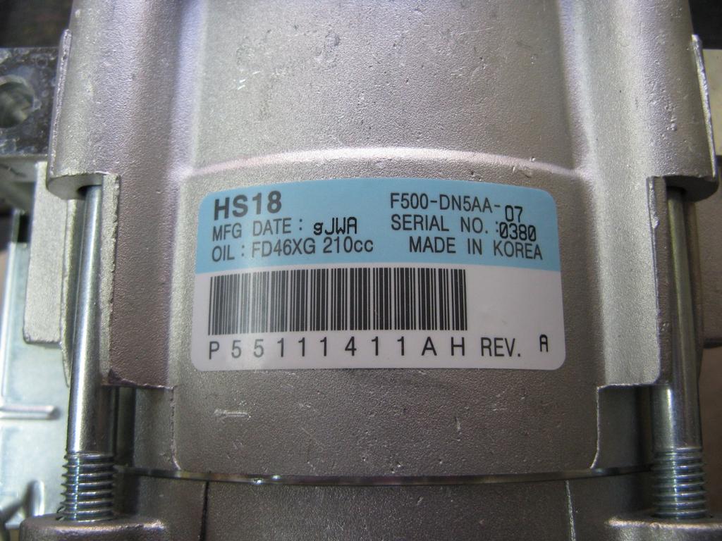

We need to know which truck in your signature the failure has occurred. If it is the '07 then the AC compressor is not a Sanden. I would STRONGLY suggest buying the orifice tube and receiver drier from the dealer. Most ALL after market parts that places like Rockauto are selling are crappy Chinese parts. The compressor for the '07, at least the one on my '07, 5.9 was made in South Korea.
Here is the picture of the REPLACEMENT Halla HS18 compressor I bought for my '07. It is the SAME as O.E. This is the picture of my spare one and here is the guy I bought them from. Nice to deal with. Chris
